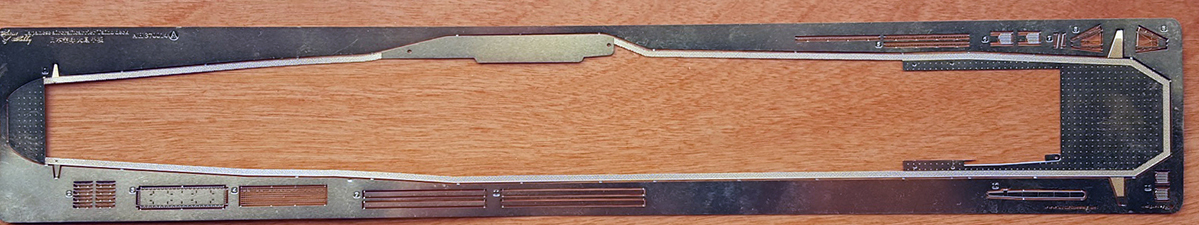

Early in 2017, Artist Hobby (AH) released several Taiho related PE sets for the Fujimi kit, among which included a flight deck set. However, this was not just another rehash of the other sets out there. AH took the unusual route of breaking up the set into the very components that I was looking for: the metal treaded deck and plating that rimmed the flight deck perimeter, and both a metal rendition of the flight deck planking as well as a wooden sticker alternative. Plus, a ton of catwalks with supports, bridge and funnel related PE. In fact, just about everything that could be rendered reasonably into PE is.
It wasn’t cheap, but it appeared to solve a lot of problems for me. I wasn’t sure how many of the components I might use but I didn’t hesitate to purchase the set. (note to potential buyers: Artist Hobby sells various components of this set separately – Basic, Upgrade, Weapons, and Flight Deck, so you can pick and choose what best suits your project.)

I had quickly determined that the Artist Hobby set would satisfy my requirements. Now, I had to solve the final issue of how to mount the custom planking. After a great deal of thought, I decided that I would do what I had considered and rejected multiple times – sanding the kit deck down enough to accommodate the styrene planking overlay without changing the overall height of the deck upon the hull. Handling it this way meant that I could use the kit deck as a substructure to retain the proper position upon the hull, and retain some deck strength.
This also meant bringing the kit deck down by 0.02”, the thickness of the Evergreen 2020 sheet. How best to handle? Certainly not by brute force hand sanding. NFW. Plus, the deck needed to remain both level and uniform all away across. My solution: I bought a 4” x 36” belt sander from Home Depot.
I know, I know, crazy, right? The over-riding hurdle is heat, as in too much too quickly, which would deform the styrene in a heartbeat. My feeling was that the amount of friction was controllable, with short stints of pressing the flight deck down on the belt for just a second or two at a time, then allowing the plastic to cool. Thankfully, a well rated sander was not as expensive as one might think, particularly during holiday sale season.
I also bought an ¾” x 36” aluminum “L” angle bar to use as both a mounting plate across the back of the flight deck (so I could hold it) and as a rigid surface to ensure the plastic flight deck remained flat. Aluminum also dissipates heat more quickly than steel. I cut the bar down to better match the length of the flight deck. I also picked up a good dust/respirator mask. I had plenty of googles.

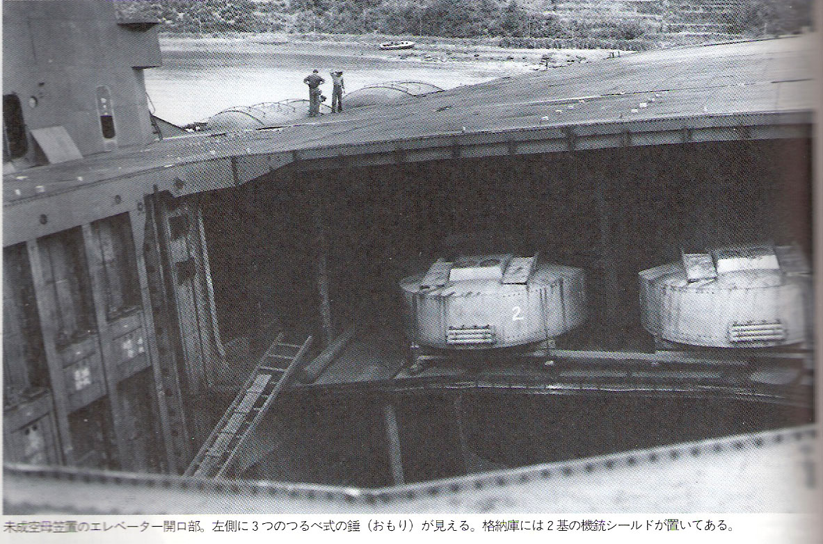

While waiting for the new paint, I decided to work on creating new, proper elevator wells. This portion of the write-up became a little lengthy, so I understand if you choose to skip right to the pics. :smallsmile:
Taiho had two elevators to service her two-story hangars, and they were placed as far apart as physically possible to enable an armor scheme that covered the hangar area in its entirety, both length and width, including the elevators. (This also meant there was no armor deck plating under the wood planking outside of that area, just regular metal plating. This was done to keep topweight down while maximizing practical coverage.) Placement at the extremities of the hangars also meant changing the shape of a typical elevator from a square or rectangle with rounded corners to one that better matched the contours of the hull far forward and aft. The forward elevator had a hexagonal shape that was elongated towards the bow. The aft elevator, while technically also a hexagon, appears more like a pentagon that is elongated towards the stern.
There are no detailed plans of Taiho’s elevator wells, only the outlines and the general shape. In fact, information on IJN elevator lifts and wells is rather sparse. There’s a few plans and drawings, some illustrations, and a handful of photos, mostly of this equipment aboard the surviving carriers taken postwar. Those carriers would include Junyo, Katsuragi, Kasagi, and Ryuho. There are some photos of Shoho under construction taken before the war that also apply. Of these photos, few of them focus on the actual elevator well area; most just happen to include portions of the wells or the lift platforms lying on a flight deck. So, some conjecture was necessary to flesh out the wells for Taiho.

PostPosted: Mon Jan 21, 2019 4:08 pm
Posts: 8832
