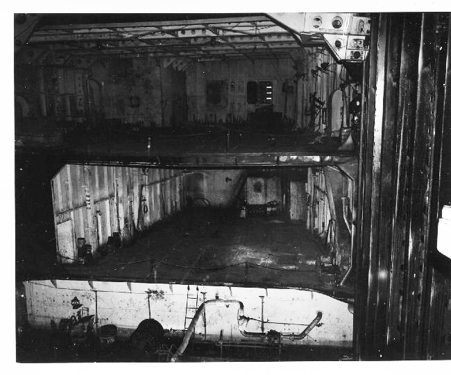

While waiting for the new paint, I decided to work on creating new, proper elevator wells. This portion of the write-up became a little lengthy, so I understand if you choose to skip right to the pics. :smallsmile:
Taiho had two elevators to service her two-story hangars, and they were placed as far apart as physically possible to enable an armor scheme that covered the hangar area in its entirety, both length and width, including the elevators. (This also meant there was no armor deck plating under the wood planking outside of that area, just regular metal plating. This was done to keep topweight down while maximizing practical coverage.) Placement at the extremities of the hangars also meant changing the shape of a typical elevator from a square or rectangle with rounded corners to one that better matched the contours of the hull far forward and aft. The forward elevator had a hexagonal shape that was elongated towards the bow. The aft elevator, while technically also a hexagon, appears more like a pentagon that is elongated towards the stern.
There are no detailed plans of Taiho’s elevator wells, only the outlines and the general shape. In fact, information on IJN elevator lifts and wells is rather sparse. There’s a few plans and drawings, some illustrations, and a handful of photos, mostly of this equipment aboard the surviving carriers taken postwar. Those carriers would include Junyo, Katsuragi, Kasagi, and Ryuho. There are some photos of Shoho under construction taken before the war that also apply. Of these photos, few of them focus on the actual elevator well area; most just happen to include portions of the wells or the lift platforms lying on a flight deck. So, some conjecture was necessary to flesh out the wells for Taiho.

The kit comes with two simplistic, one story wells that are completely enclosed, with some shallow counterweight channels set on opposing walls. These are extremely basic, incomplete, and far from accurate, but that’s what passes for Fujimi fare these days, unlike, say, Aoshima or Pit-Road as of late. I will say that Fujimi did do a very good job of getting the platform shapes right, particularly as the sidewalls of the forward elevator have some toe-in slightly towards the bow and cannot be parallel. While there is no documentation, I also think their placement of the counterweights and channels makes sense, broken up into two sets per side. More on that in a bit.
I’ve made my own elevators and wells in the past, but this time, I thought I would take advantage of some very nice PE versions made by Rainbow. I spent a lot of time examining them and came to the conclusion that, as nicely engineered as they are, they weren’t quite accurate in how they depict the elevator sidewalls with their counterweight channels. So, I decided that scratch-building would again be the best solution. I wanted to display the elevators with the options for fully raised or lowered positions.
