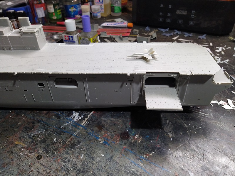

After much agonizing over the cost I finally bought the Trumpeter 1/350 Wasp and began the conversion.
