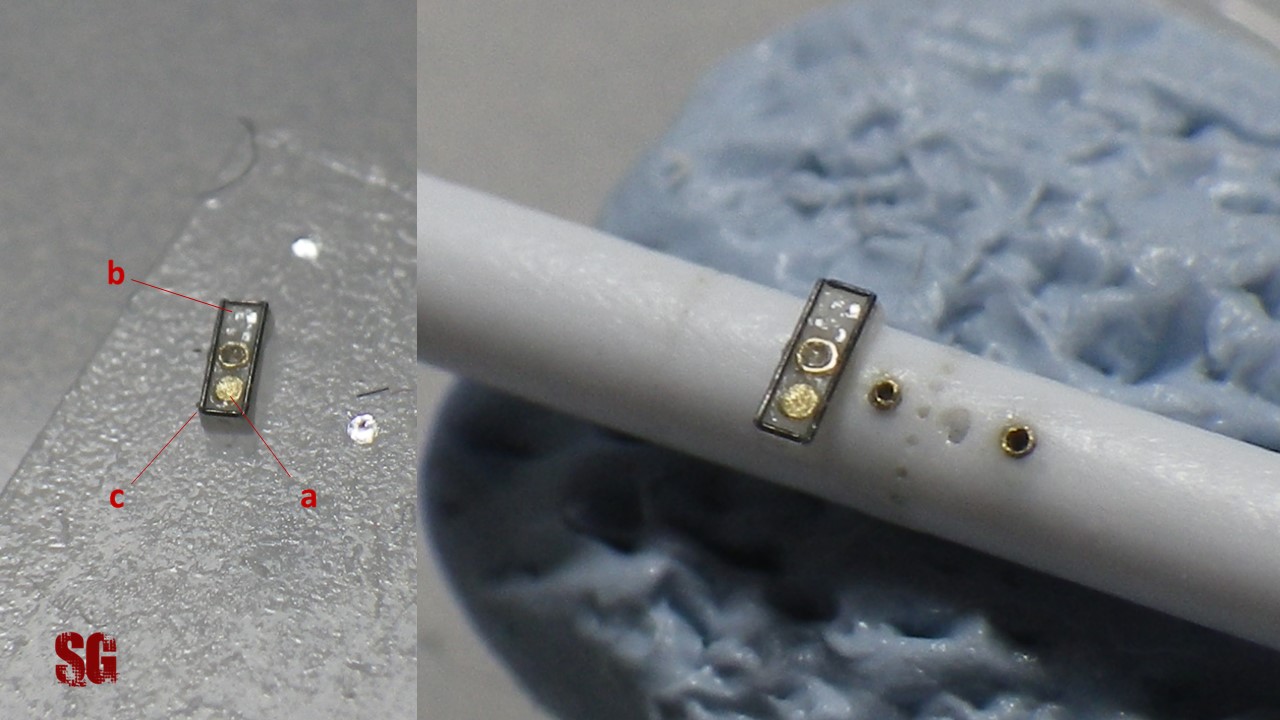

Hi, I thought there might be room for improvement and decided to push myself to the limits. I drilled another hole for the depth gauge (a) and filled it with a 0.13 mm-thin section of 0.3mm brass rod; I "punched" 4 x 0.1 mm aluminium foil "dots" with a homemade micro p&d (don't try this at home, it seldom works
) and glued the dots to represent the ammeters and voltmeters on the right of the panel (b): the dots kept disappearing among the bristles of the carrier-brush and aligning the few of them that made it to the cluster was a pure statistical exercise
. Finally, i tried to smooth out the corners of the frame sanding it gently with 2000 grit sandpaper to avoid disassembling the frame elements (c). The result is more pleasing to the naked eye than seen through the merciless camera magnification. Trying to capture all the new elements in a picture was difficult due to the different reflections of every single detail.
The idea is to provide some extra texture to be enhanced with drybrush over the black instrument panel, before creating the glass over it. Theoretically it should improve detailing. We'll see. Something i won't be repeating anytime soon by the way

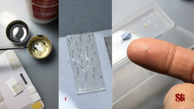

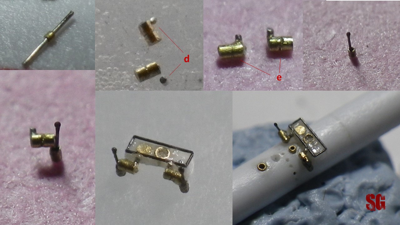

added the controls for the trim pumps to the instrument cluster (several styles existed, a, b, c). Opted for a single subassembly to spare myself from the difficulty of gluing the single components to the SLC at a later stage, when the surface of the torpedo will be filled with details. There should be room for a better alignment of the controls using controlled "pin washes" of CA debonder i hope. Placing a single subassemblied element instead of three should make it easier.
Each cylindrical horizontal part is composed of two tiny sections of 0.2 mm brass tubing mounted on a 0.1mm rod section. Overall lenght of the combos is 0.3 mm. I left in place the burr that formed-up at the edges after diamond-filing the sections of tubing to simulate the raised connection-rim between the components of the real thing (e).
Each horizontal part was glued to the corresponding vertical element, made of a 0.17ish mm wide x 0.2 mm tall tubing section hosting a trim pump lever made with 0.046mm wire that has a knob on top.
Obtaining the 0.17mm-wide tubing sections was a laborious affair, basically the brass tube is rolled over the surface of a CD with a diamond file checking width reduction time by time, stopping before the tube breaking point is reached.
The knobs on top of the levers are micro blobs of white glue applied with the tip of a 5/0 brush. I used "The Baumann Technique" of mixing white glue and watercolour, in this case black. It is a very effective technique to control the apposition of the micro blob of glue and the build-up of the knobs, making them visible after the glue has cured. THANK YOU MR BAUMANN, this is an official tribute.
I prepared a "forest" of levers with different heights ranging from 0.5 to 0.8 mm and chose the most appropriate ones according to the pictures of the real thing (f).
Gluing the controls to the instrument cluster was a matter of trial and error. I prepared a jig to help adapting the controls to the curved surface of the torpedo. The weak point of my work was the choice of 0.1 x 0.1mm wire for the spacers (d). The minimal contact surface was very difficult to control when gluing the parts. Am happy of the result, although i think there's still room for improvement. I am tempted to undo the work and go for squared/thinner spacers made of self-adhesive aluminium tape to simulate version (c) thinner spacers. We'll see. The complete subassembly is really small, as i discovered when i tried to man the levers with my index finger
. Enjoy the result of my work.

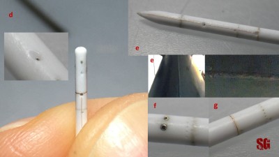

Once back at home i decided to superdetail the warhead of my SLC model according to the new findings and to craft a new quick release gear.
- Two 0.2 mm oblique holes were drilled on the bottom midline of the warhead, then drilled 0.1 holes deep in the 0.2mm tunnels and added tiny sections of 0.1 wire to simulate the plain primers (d).
- The welding line was simulated by glueing a 0.01 mm copper wire section all along the bottom midline of the SLC body (e). I used a 0.02mm copper wire applicator to run ultrathin CA along the joint and sanded the weld line with 2000-grit sandpaper to reduce bulking which i must say is nearly imperceptible.
- Drilled another nut ring further aft of the breaking line (f) and added the band at the warhead demarcation line, made of 0.03 mm copper wire (g).

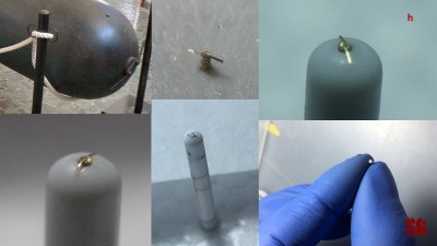

- Finally crafted a new version of the quick release gear (h) with a section of 0.2 mm brass rod protruding the right amount this time (
) and a tiny strip of 0.01 mm-thin brass shim (measuring 0.7x 0.05 mm) which was very difficult to craft, align and glue.
