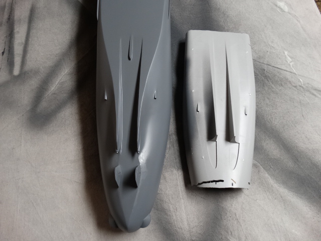

Mike - I also can't find a discussion of how I did my hull in the build log either; why - I can't explain now, perhaps I did...don't recall now. I know I had started a mini-topic on that topic that I had planned to post and never did. Anyhow, a bit of history on others who also have modified the 1/200 Trumpeter hull:
Jason Channell - used a plank on bulkhead type method for internal supports with styrene strips as replacement for his hull after cuttting out a section of the original hull - covered with putty and sanded smooth. Here are a few photos I saved from his method:
His internal bulkheads added inside the hull:
And his finished hull:
One other member also did (what I would consider the BEST METHOD) a complete hull replacement of the last 19 inches of the hull - this was a 3D designed/printed replacement for the after part of the hull. He used a high-end 3D CAD program (Solidworks, I think but I could be wrong) to do the design and also created internal bulkheads within the hull for structural strength.

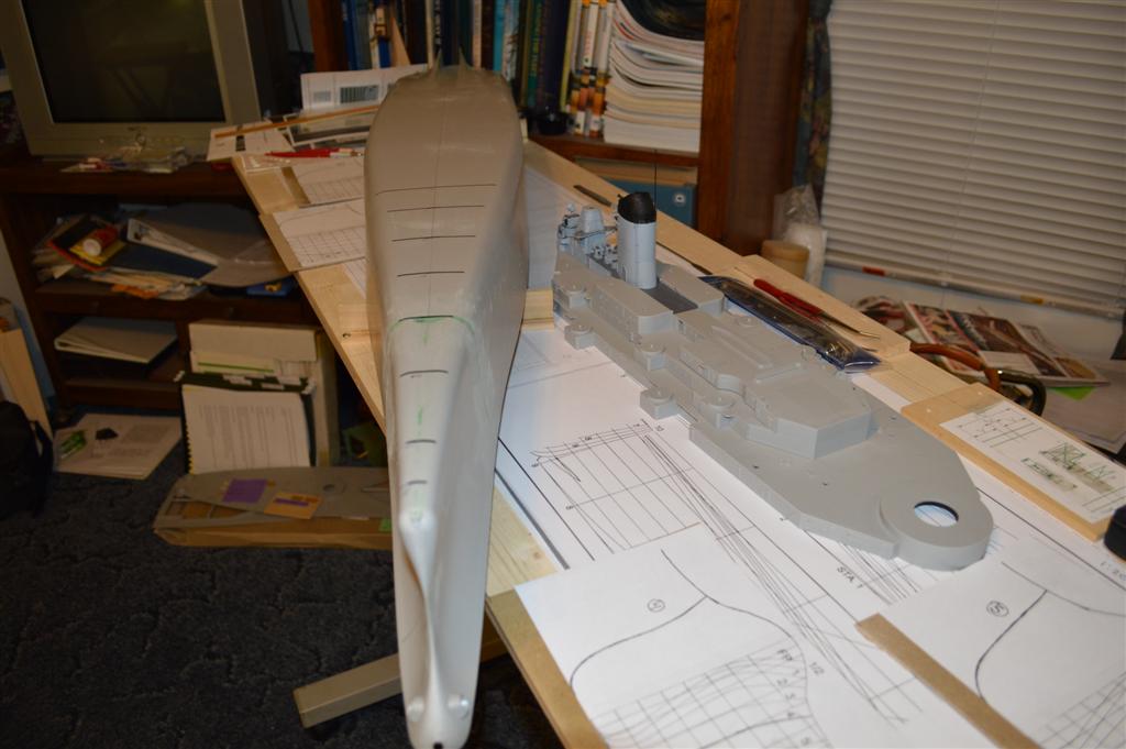

And, I did my hull totally different by filling the interior of the worst affected area of the hull (behind turret 3 back about 6-8 inches). I also rebuilt the forward lower hull to widen the bulb area which is also incorrect.
Bow area - I made section templates from the IOWA class body plan and then adhered them to cardboard. Here is a photo of them in place:
The templates allow you to see how much new material you'll need to add to get this area to the proper shape & thickness. This was after I had mark the hull w/magic marker to location the section lines:
I built up the forward section using styrene strips and putty and then sanded these down to shape. Not what I would term now a desirable method - due to my experimenting with liquid glue which didn't work well. If I were to do it over, I would use CA or styrene cement. Here is a shot of the forward hull with the station lines marked:
