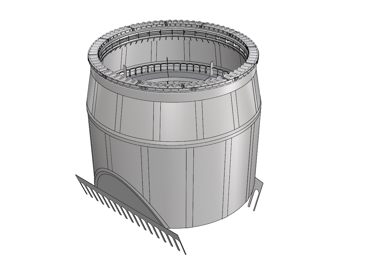

While I am pontificating, here is something I did last week. Turret No. 1 on Iowa/New Jersey. Note that this is quite different than what you may have seen in some references.
attachment=0]ViewCapture20221018_160339.jpg[/attachment]

Your turret barbette rendition is quite interesting, to say the least. Hadn't seen a view of it quite like that! And the shape - I won't comment except to say that I know you have documentation to stand behind your entry.

DavidP wrote:
what are those hair comb shaped things at the lower sides of the barbette?
They are supports that extend down to the hold that transmit the force from the side of the turret.
There is a photograph in here
https://www.amazon.com/Visual-Battleshi ... 098998043X
It looks to me like kits have copied the Tamiya hull form and either blown it up or added plating and have preserved the original mistakes.
