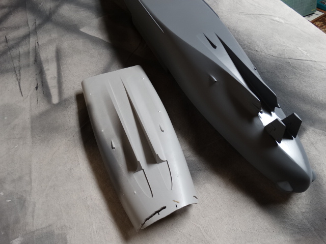

Timmy C - thanks for locating my build - I'm guessing at how this was filed (by creation date, which I had forgotten!). Anyhow, I'll bookmark it for future reference!
Mike - I also can't find a discussion of how I did my hull in the build log either; why - I can't explain now, perhaps I did...don't recall now. I know I had started a mini-topic on that topic that I had planned to post and never did. Anyhow, a bit of history on others who also have modified the 1/200 Trumpeter hull:
Jason Channell - used a plank on bulkhead type method for internal supports with styrene strips as replacement for his hull after cuttting out a section of the original hull - covered with putty and sanded smooth. Here are a few photos I saved from his method:
His internal bulkheads added inside the hull:
And his finished hull:
One other member also did (what I would consider the BEST METHOD) a complete hull replacement of the last 19 inches of the hull - this was a 3D designed/printed replacement for the after part of the hull. He used a high-end 3D CAD program (Solidworks, I think but I could be wrong) to do the design and also created internal bulkheads within the hull for structural strength.

If I were to recommend a method to use, it would be probably something along the lines of what Jason Channell used as his method was a lot more logical in some respects, and certainly a bit easier in the long run. A complete replacement of the last 19 inches of the hull would be the answer, but unless you know 3D solid modeling or someone who does (and is into ship hull design) then that option may be moot.
I hope this helps; this is a BIG undertaking for anyone to accomplish!
