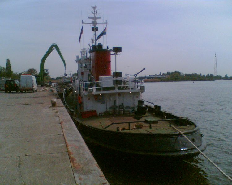

Hey guys,
A couple of years ago I already started a build like this, only due to moving to some different houses the old hull got damaged beyond repair.
This year I decided to start a new build of an LT army tug.
It is the LT 1973.
I did see it a couple of years ago in the harbour of Rotterdam.
I got a full plan of pdf yard drawings available.
The vessel will be the modernised version, the LT 1973 has been the prototype for the modernisation of 7 or 8 of these vessels for joining in the Gulf War Operation Desert Storm.
More info about this will follow.

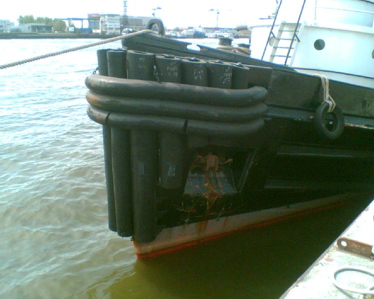

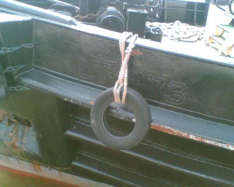

Some more pictures I took when it was moored in Rotterdam.

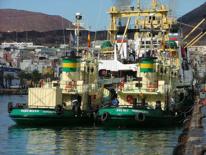

When I get home from holiday I will post the article about the modernisation of the vessels.
3 of the modernised vessels have been refurbished and repainted a couple of years ago at a yard close to my home. A friend of mine did the transportation from England to Holland.
2 of these vessels are the Ogbomoso and the Balali. Both sold to Nigeria.

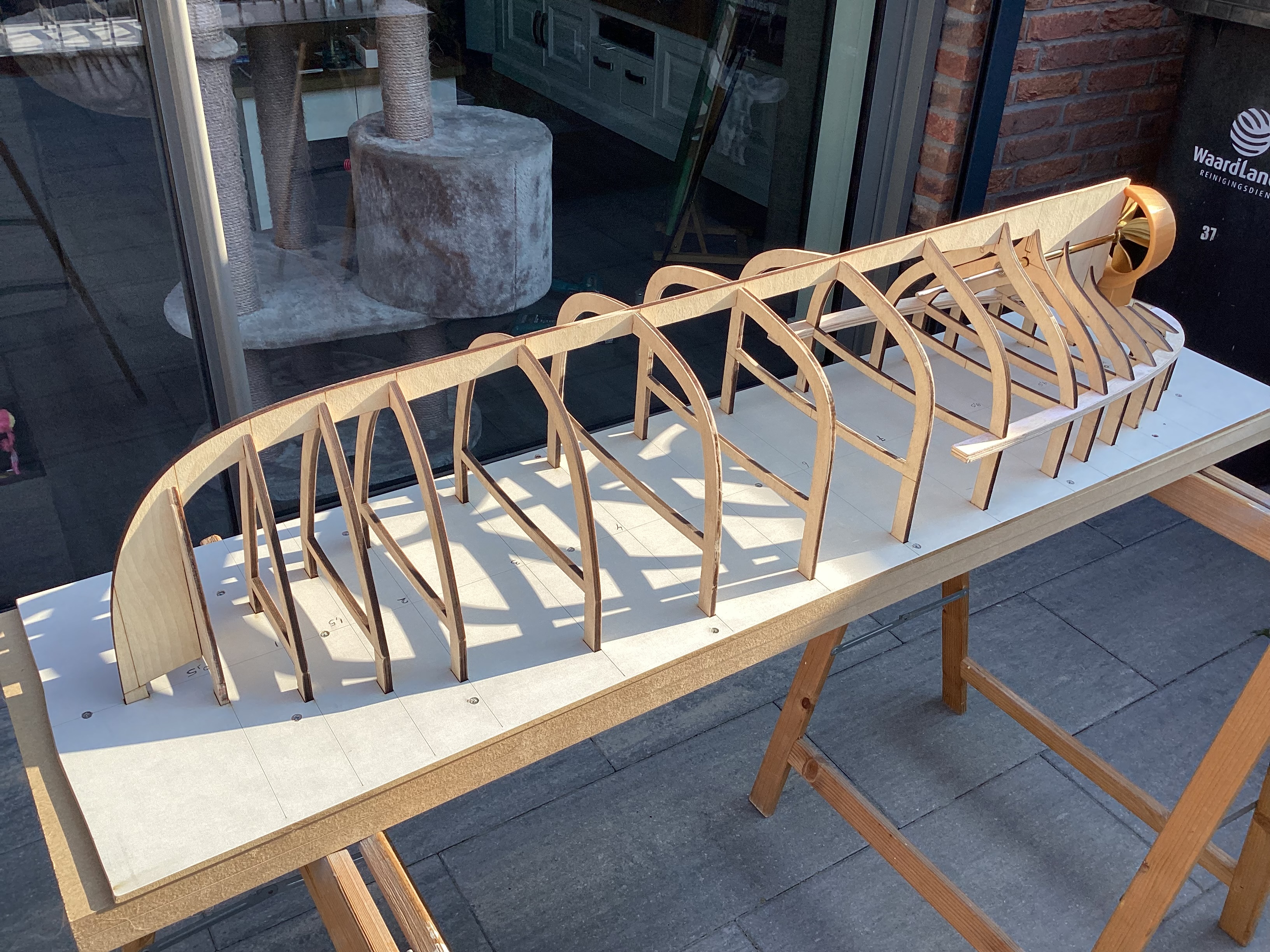

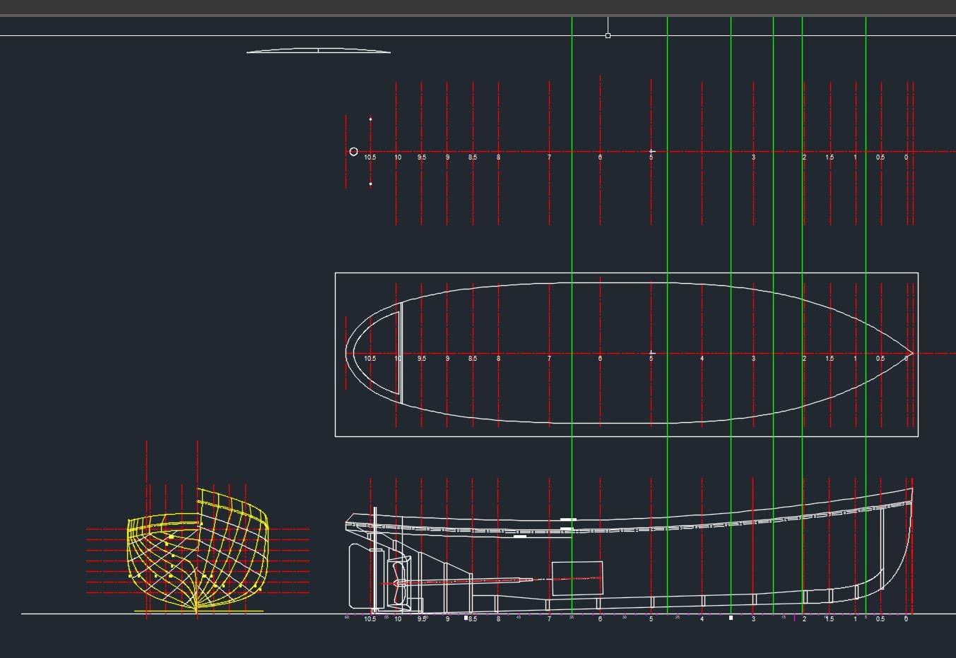

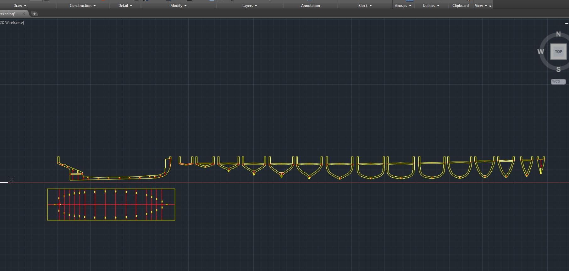

A couple of weeks ago I started drawing the frames in AutoCad.

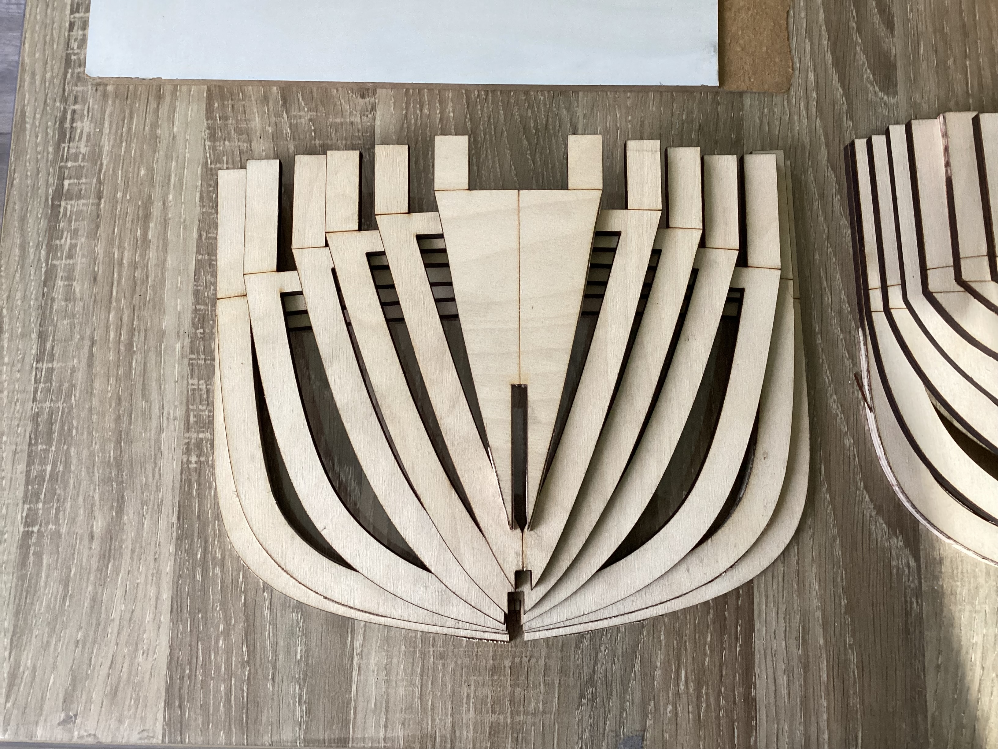

Parts are cut by a friend on his lasercutter.

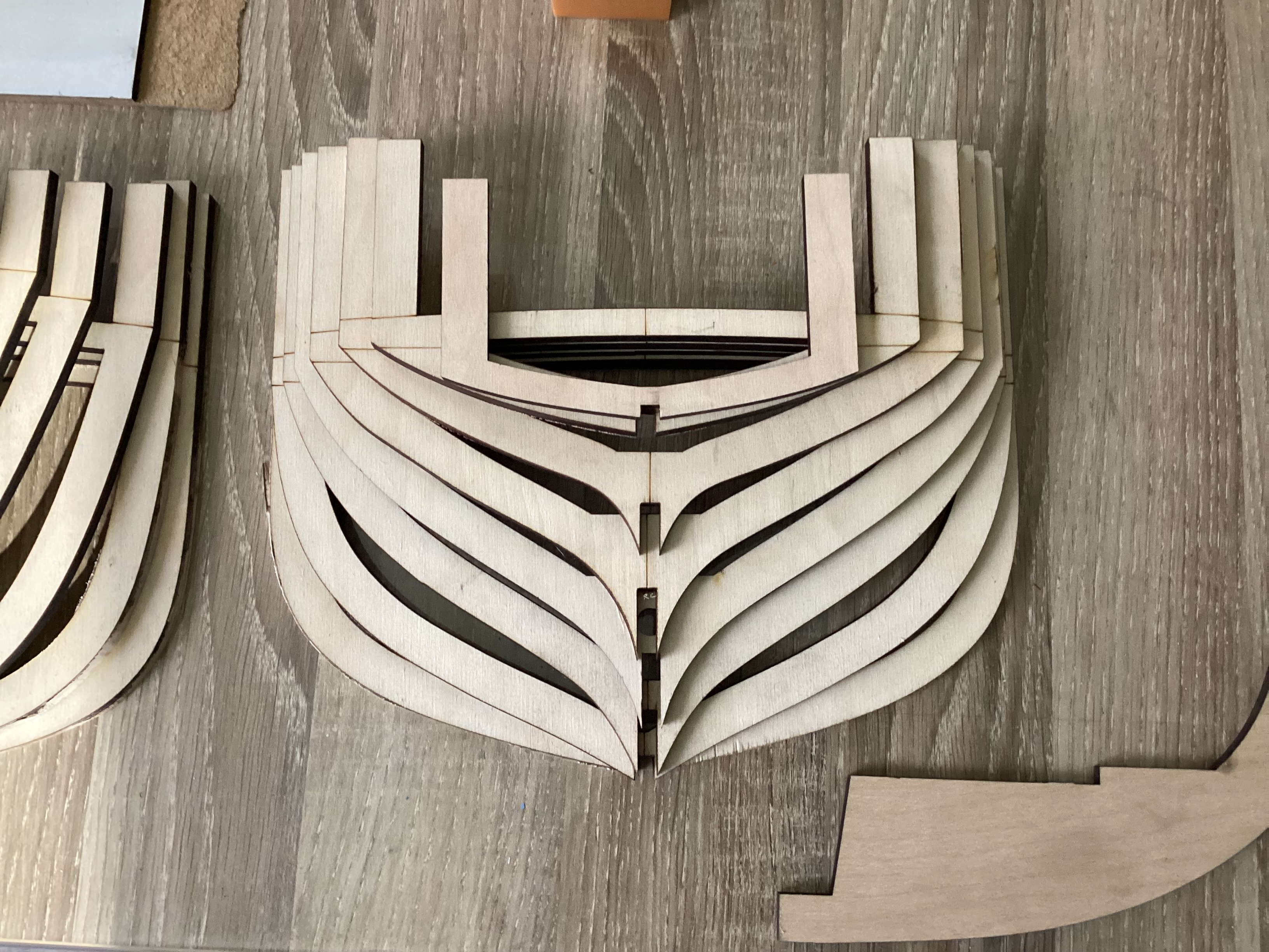

File comment: Template for the frames.
File comment: All parts incl. prototype nozzle.

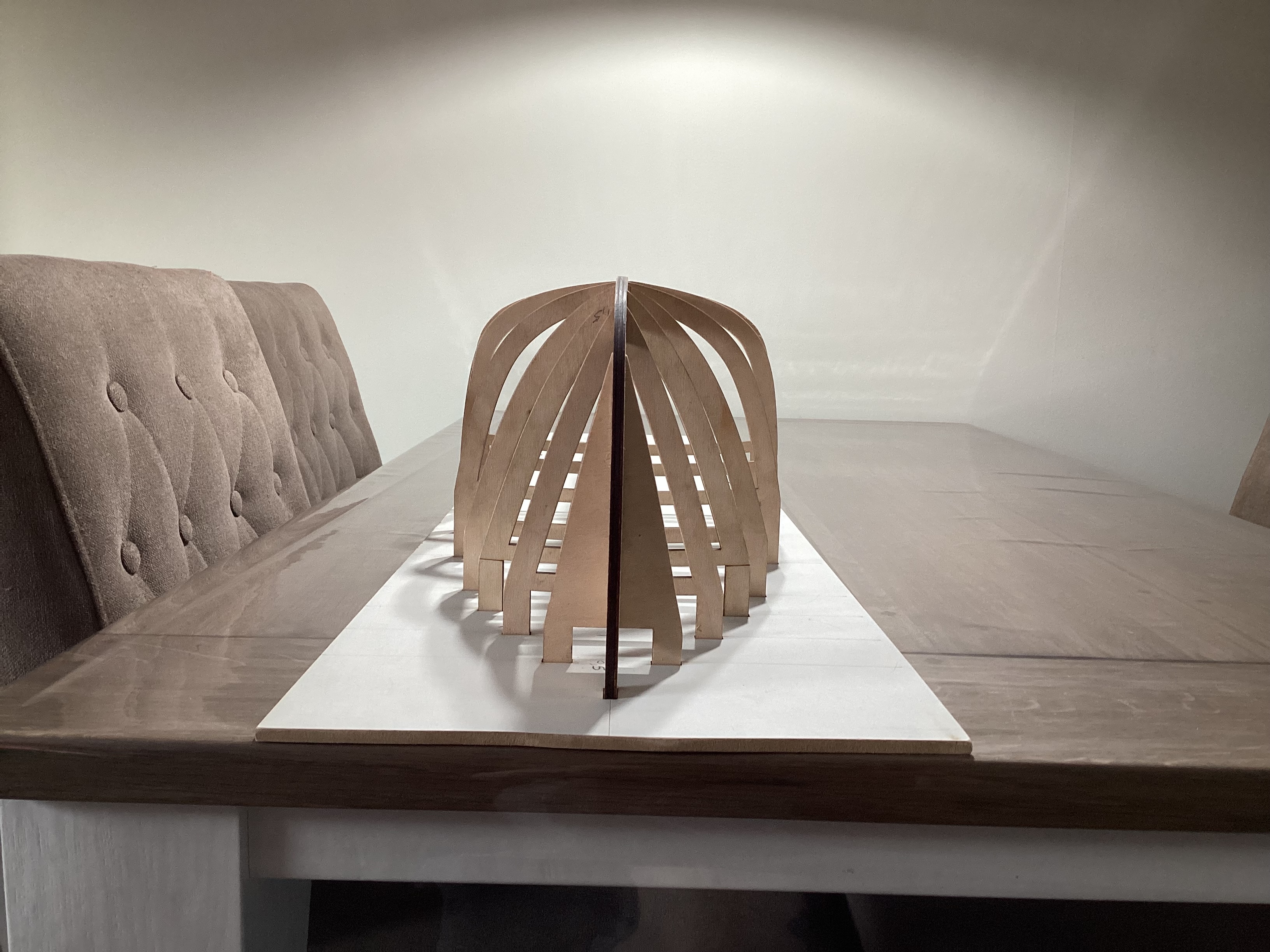

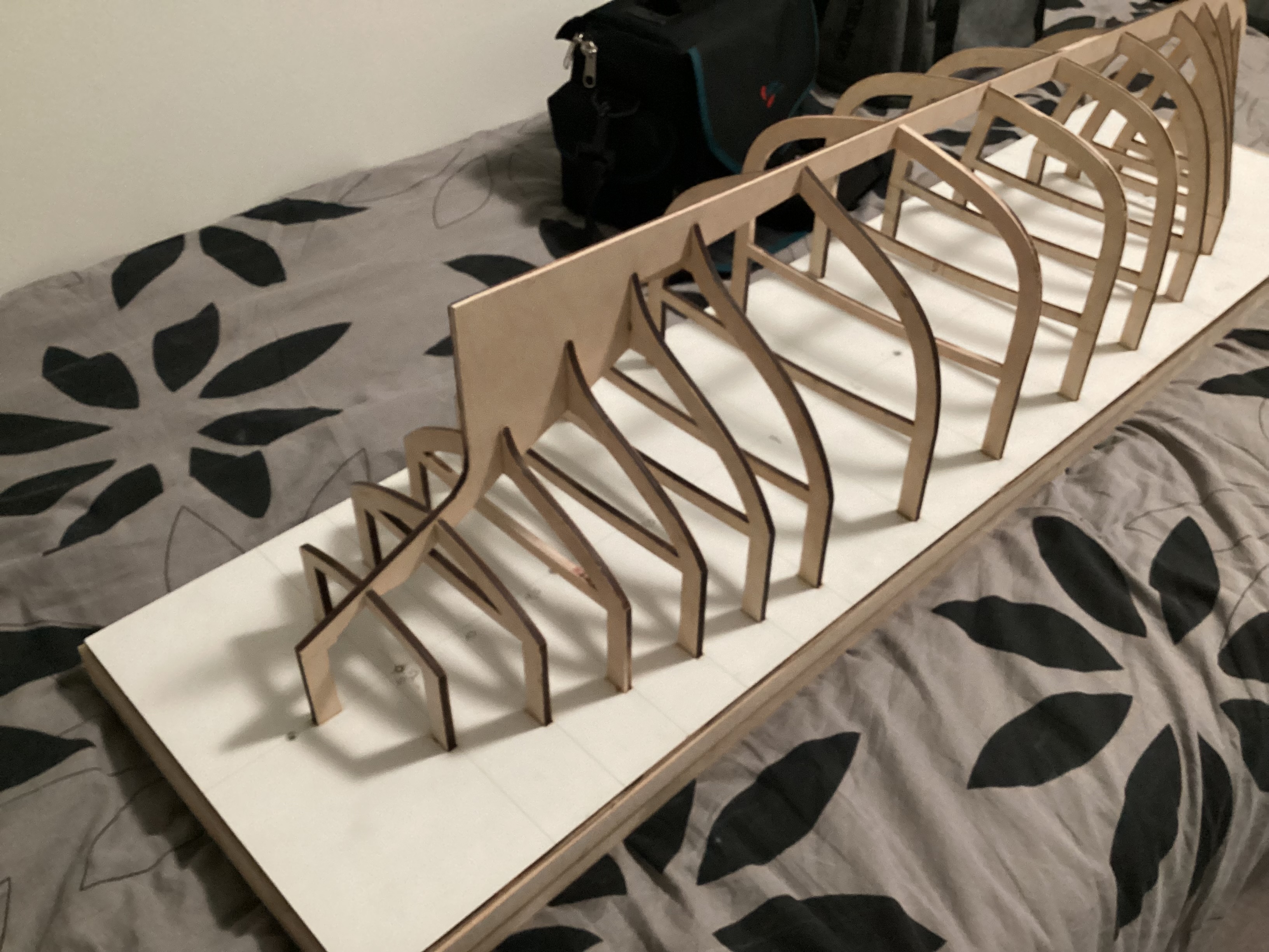

Dryfit.

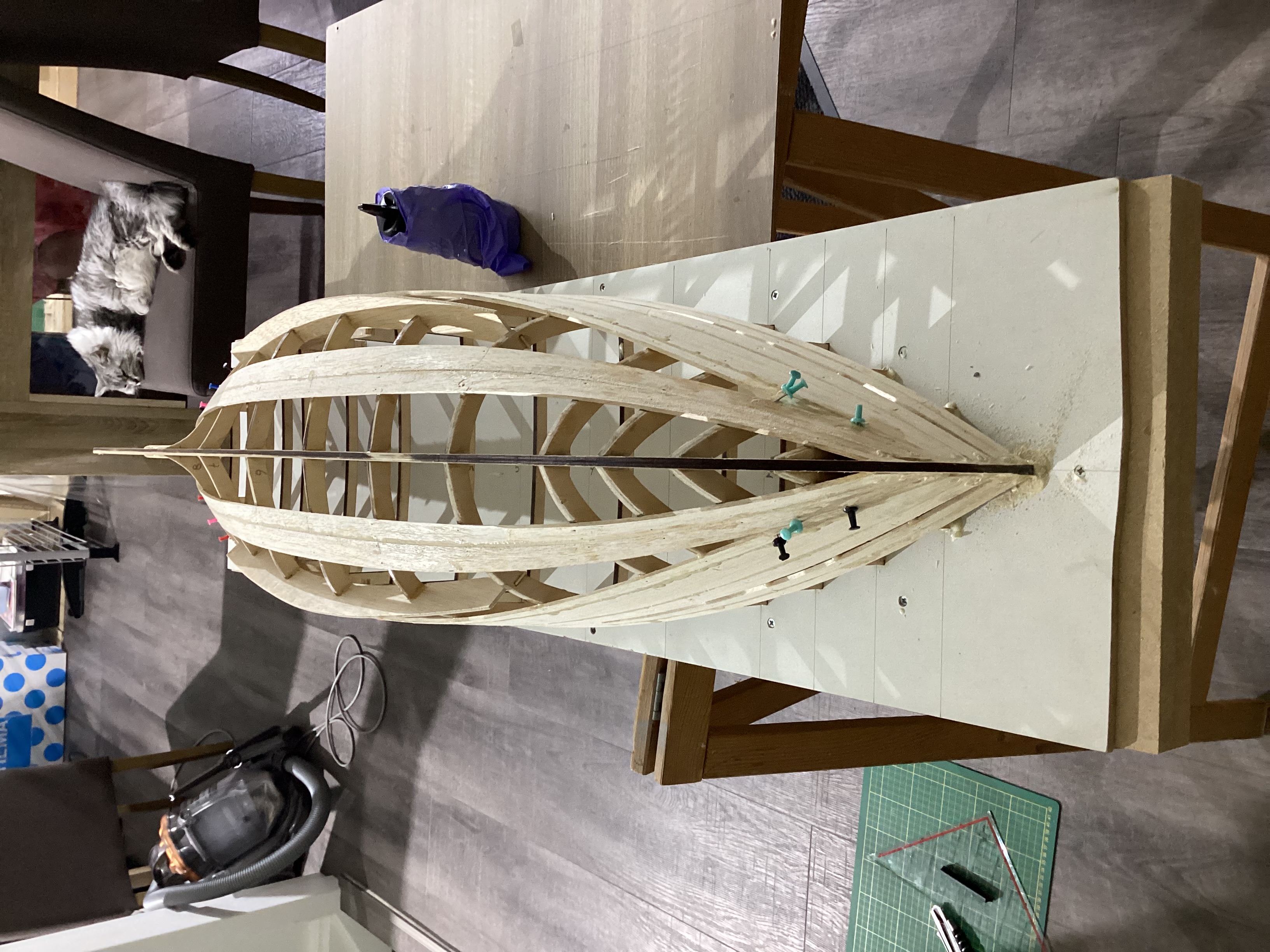

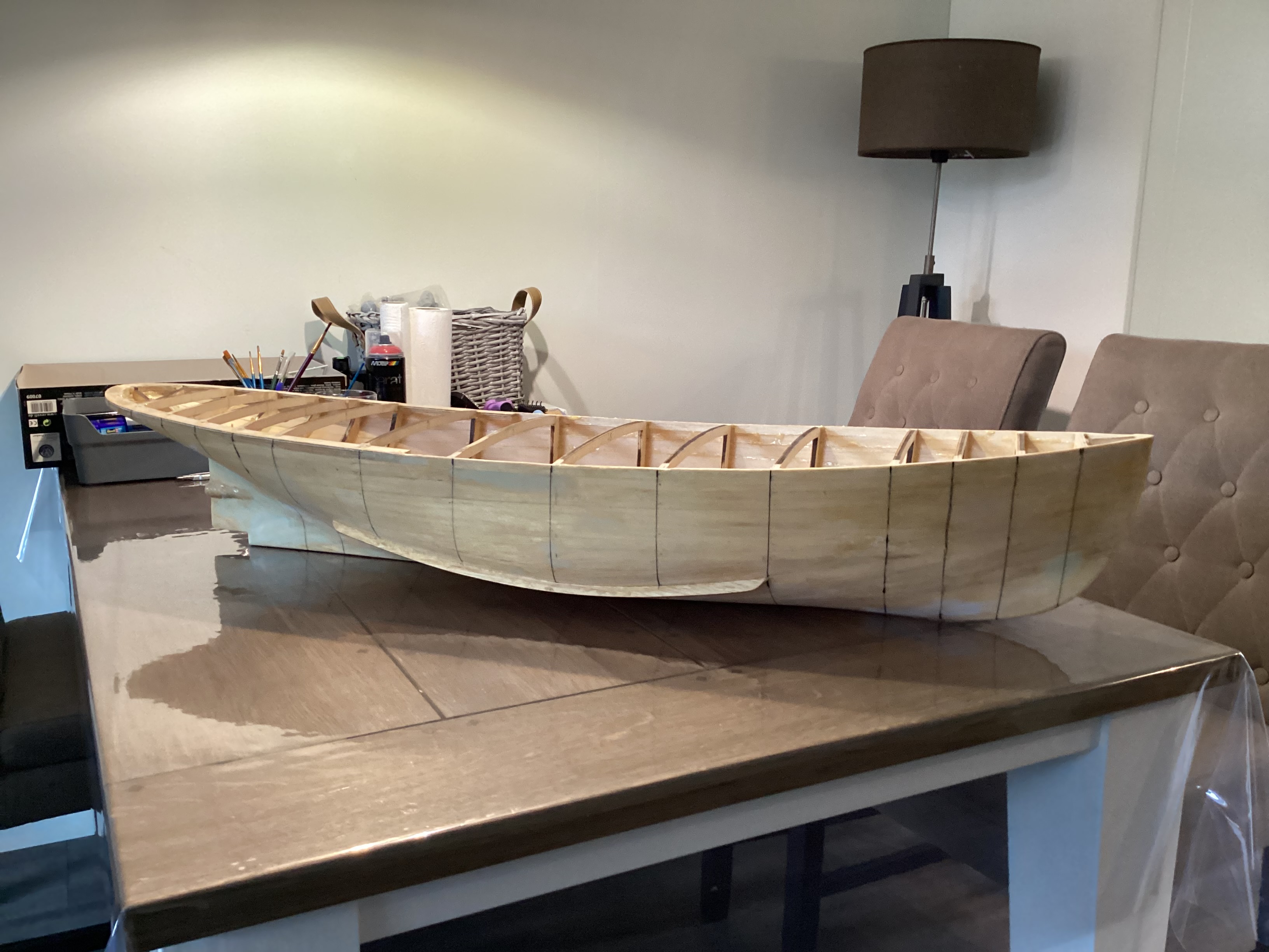

3mm balsa glued in place.

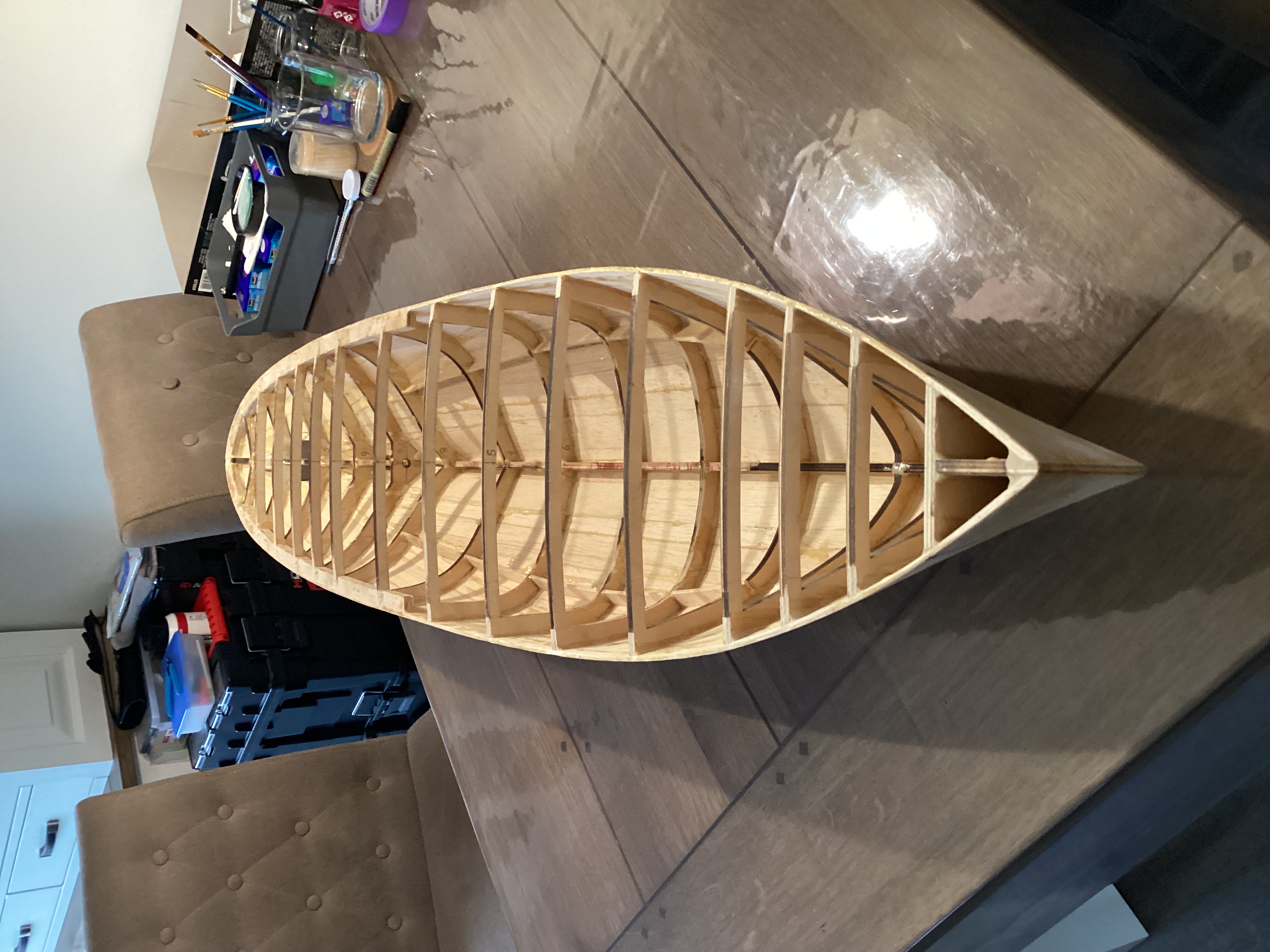

More planking.

Front finished, now working on the aft ship.

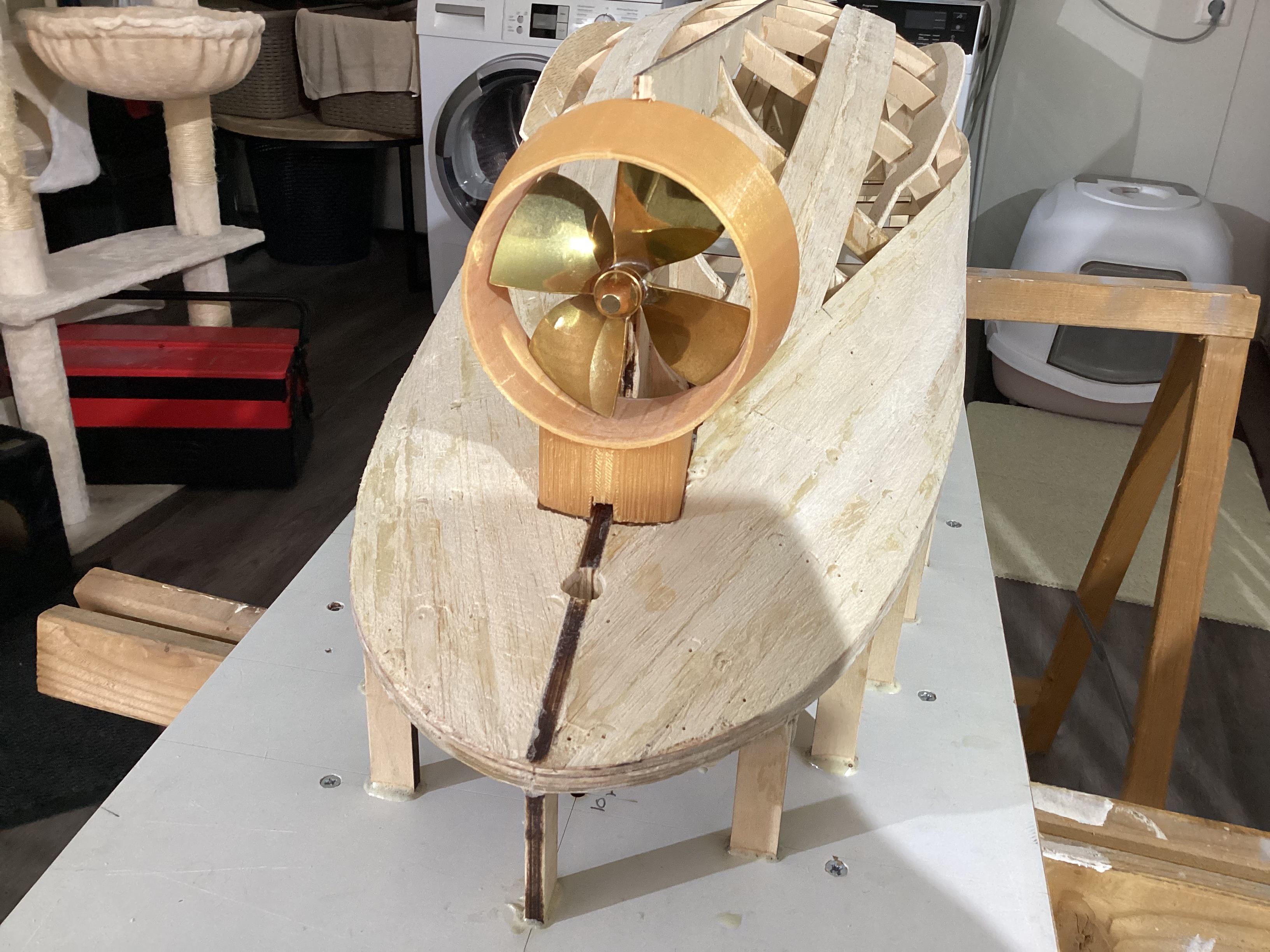

At this moment I am working on a new nozzle design. Some parts need to be removable to dismount the rudder.

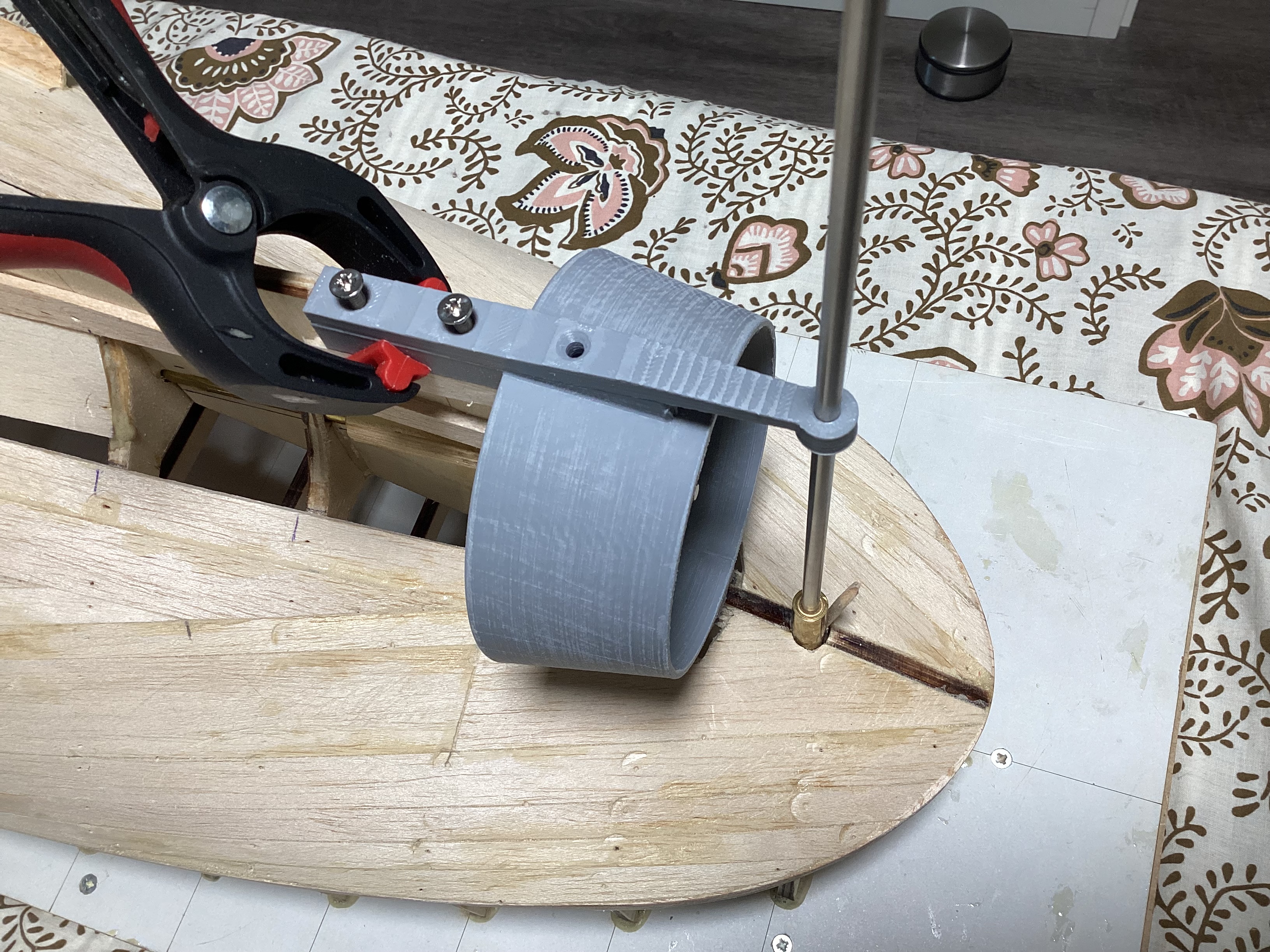

Printing the prototype nozzle.
 Post subject: Re: LT Army tug 1/30
PostPosted: Fri Aug 11, 2023 9:57 am
Posts: 1890
Location: Bretagne, France
Nice progress :thumbs_up_1:
Pascal
PostPosted: Fri Aug 11, 2023 10:07 am
Joined: Tue Jan 04, 2022 2:29 pm
Posts: 22
Testfitted.
Overall dimensions are ok, some minor adjustments need to be made on the hole positions.

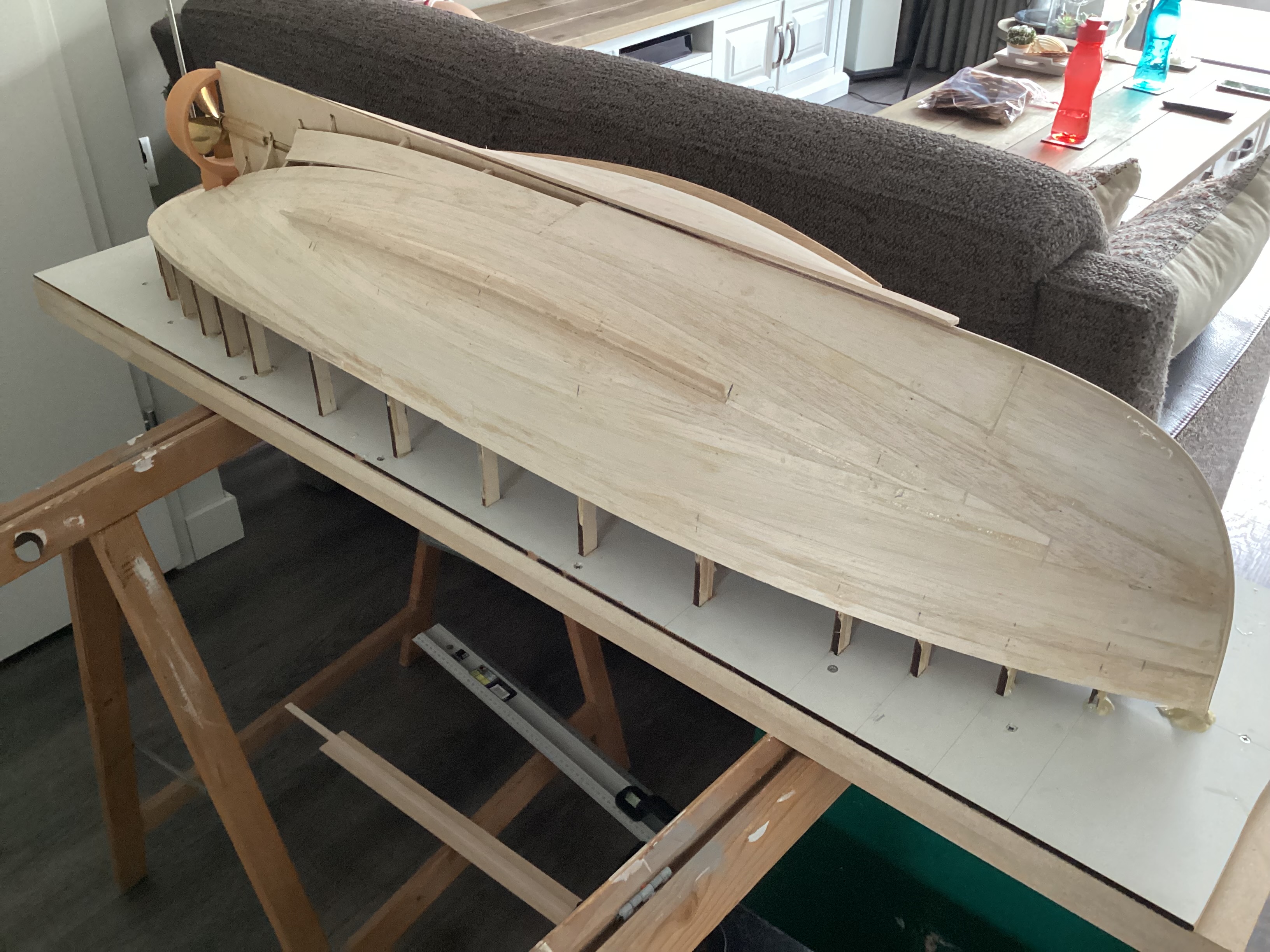

Closed the hull this week after several weeks of no time.
Now it is coated in PU resin. After sanding the hull will be smoothed out with putty.

After a long time finally it is off the board.
Was too busy at work the last couple of months.
It is looking great!

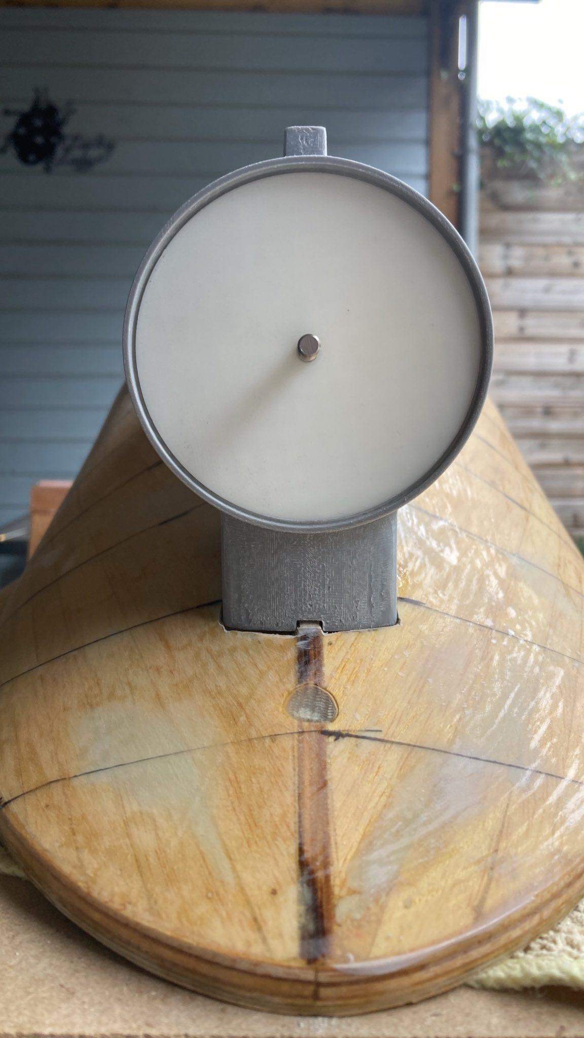

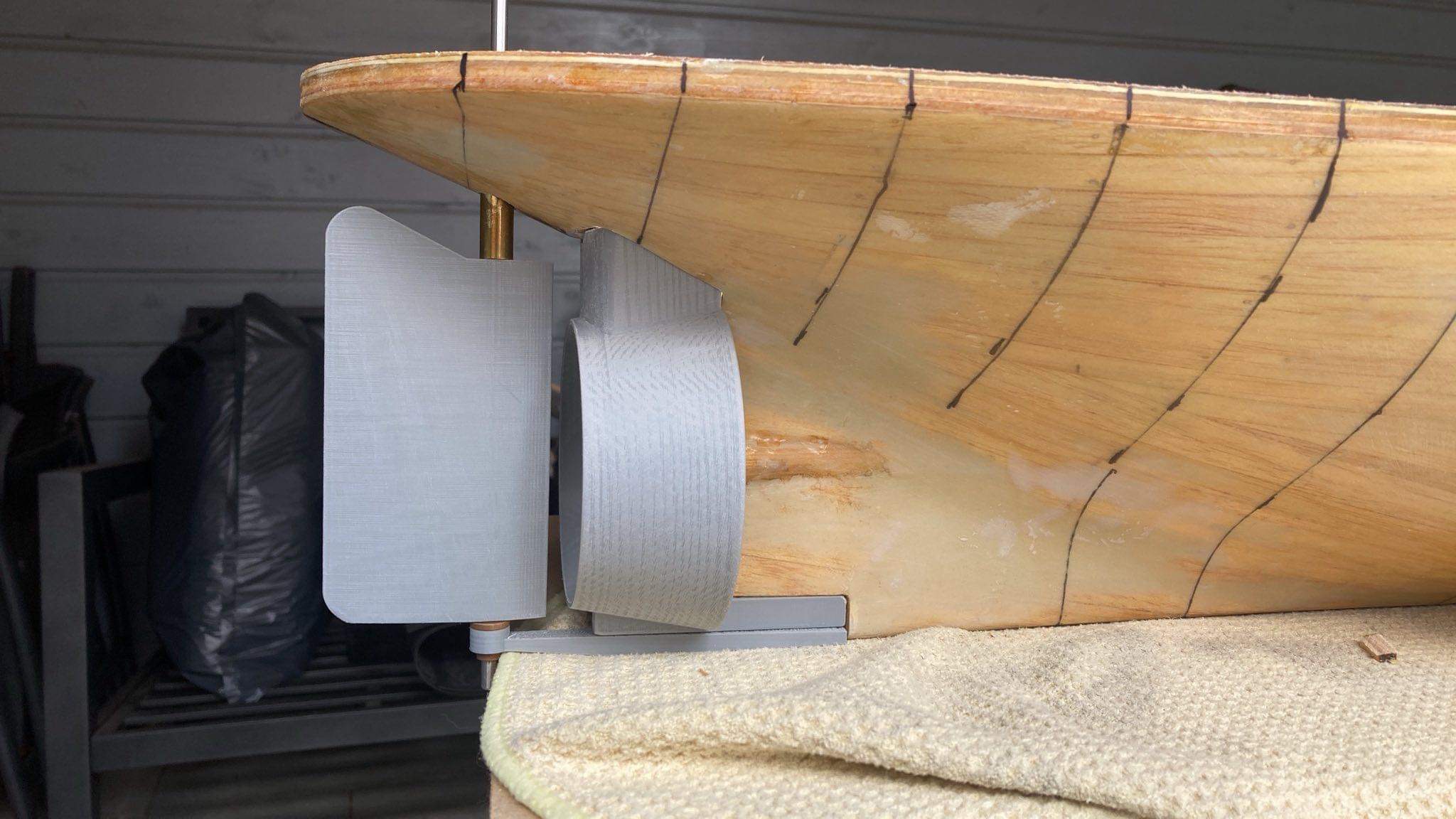

Propulsion fitup.
