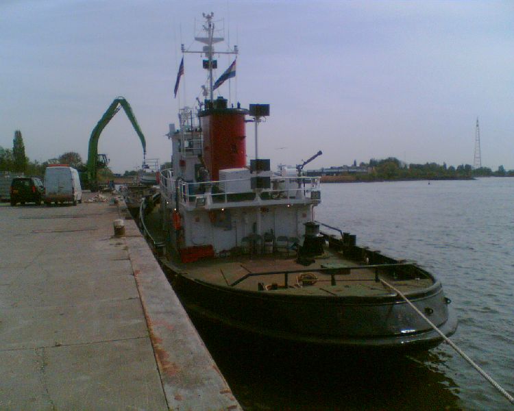

Hey guys,
A couple of years ago I already started a build like this, only due to moving to some different houses the old hull got damaged beyond repair.
This year I decided to start a new build of an LT army tug.
It is the LT 1973.
I did see it a couple of years ago in the harbour of Rotterdam.
I got a full plan of pdf yard drawings available.
The vessel will be the modernised version, the LT 1973 has been the prototype for the modernisation of 7 or 8 of these vessels for joining in the Gulf War Operation Desert Storm.
More info about this will follow.

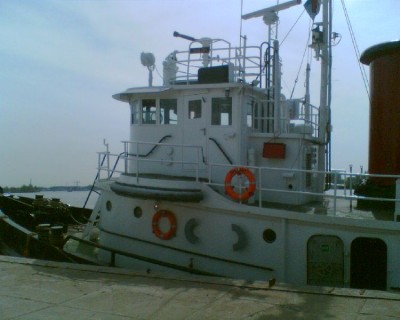

Some more pictures I took when it was moored in Rotterdam.

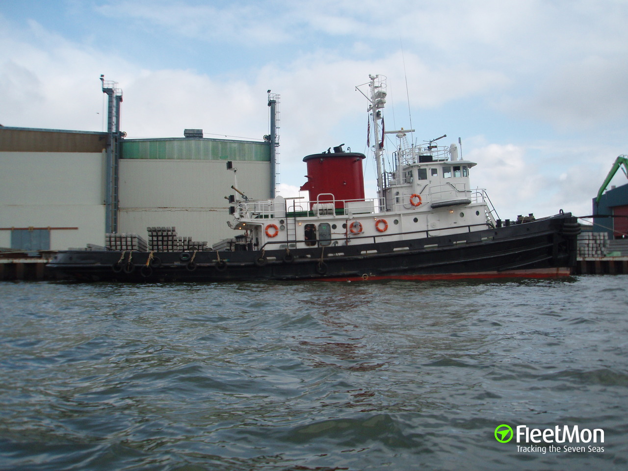

Nice projet. This type of tug are very nice.
https://www.balticshipping.com/vessel/imo/9069841
A HD pictures found on Flickr:
2009.
"Shiloh", ex-US Army 'LT 1973', Falmouth Harbour, 19.05.09, as seen from passenger ferry Enterprise 3 on her way up to Truro. She was built in 1954 and is now privately-owned. Thanks to Ivan S. Abrams for the tug history data. 24.01.10 - Update. Tug has recently left Falmouth to travel to Hull via Portland to collect a barge. She will then be taking a long voyage to West Africa to start work towing logs. She is now owned by a company called Buchanan Renewable Energy.
HD picture : https://live.staticflickr.com/2295/3604 ... 6dc_4k.jpg
Pascal
