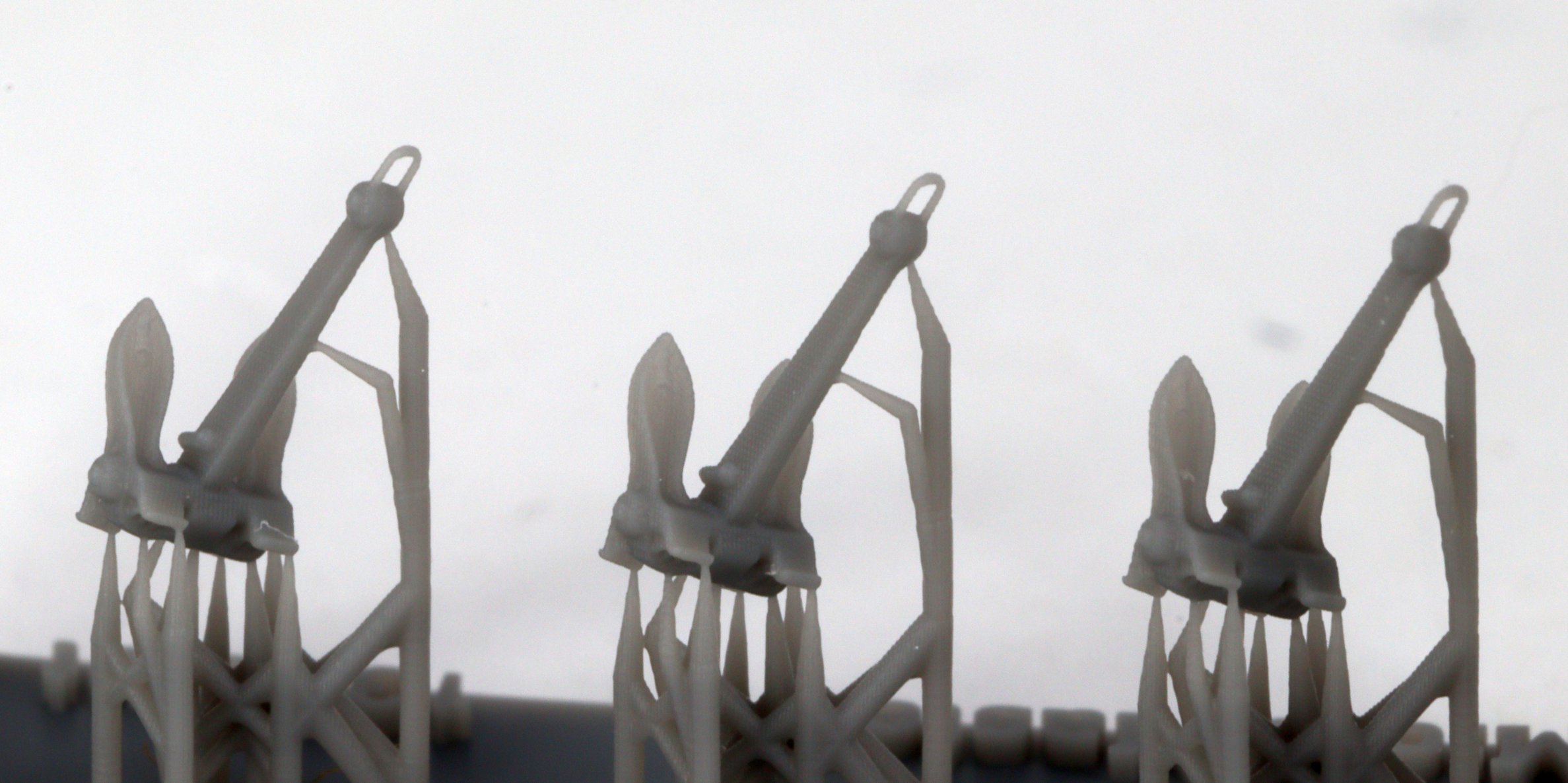

3D parts by Micro Master
Besides the enormous help by Brett Morrow the other main contributor to my project is Simon Percival of Micro Master. We´ve been in touch with Simon since the days of my HMAS Canberra project so it was only logical I asked him for help with the Australia.
All Simon´s 3D parts are being designed in very large scale with an enormous level of detail so they can be provided in any reasonable scale depending on the customer´s wish. The quality of Simon´s design and printing cannot be overstated, they are simply excellent, as can be seen on the attached photos. Remember this is all 1/700 so the details are really extremely tiny and stand out in the macrophotography. The print layers are OTOH actually invisible on those parts after painting and using appropriate weathering techniques.

As can be seen on some of the close-ups, Simon has the supports extremely thin where they attach to the actual model, so they snap off really easily using Exacto or tweezers. He suggests putting the prints into the fridge to make removing supports easier, but that was never necessary in my case. Perhaps with larger scales the supports mave to be more substantial, I don´t know.
Hope I won´t let you down about the scratchbuilding - I´m using my PE in place of that, except if I made a mistake in the design :big_grin: or small cylindrical parts that are easier to cut off plastic rods than do from PE. That was in fact behind me starting with designing PE cause I disliked me not being able to become a good scratchbuilder, especially when it came to repeating parts.
