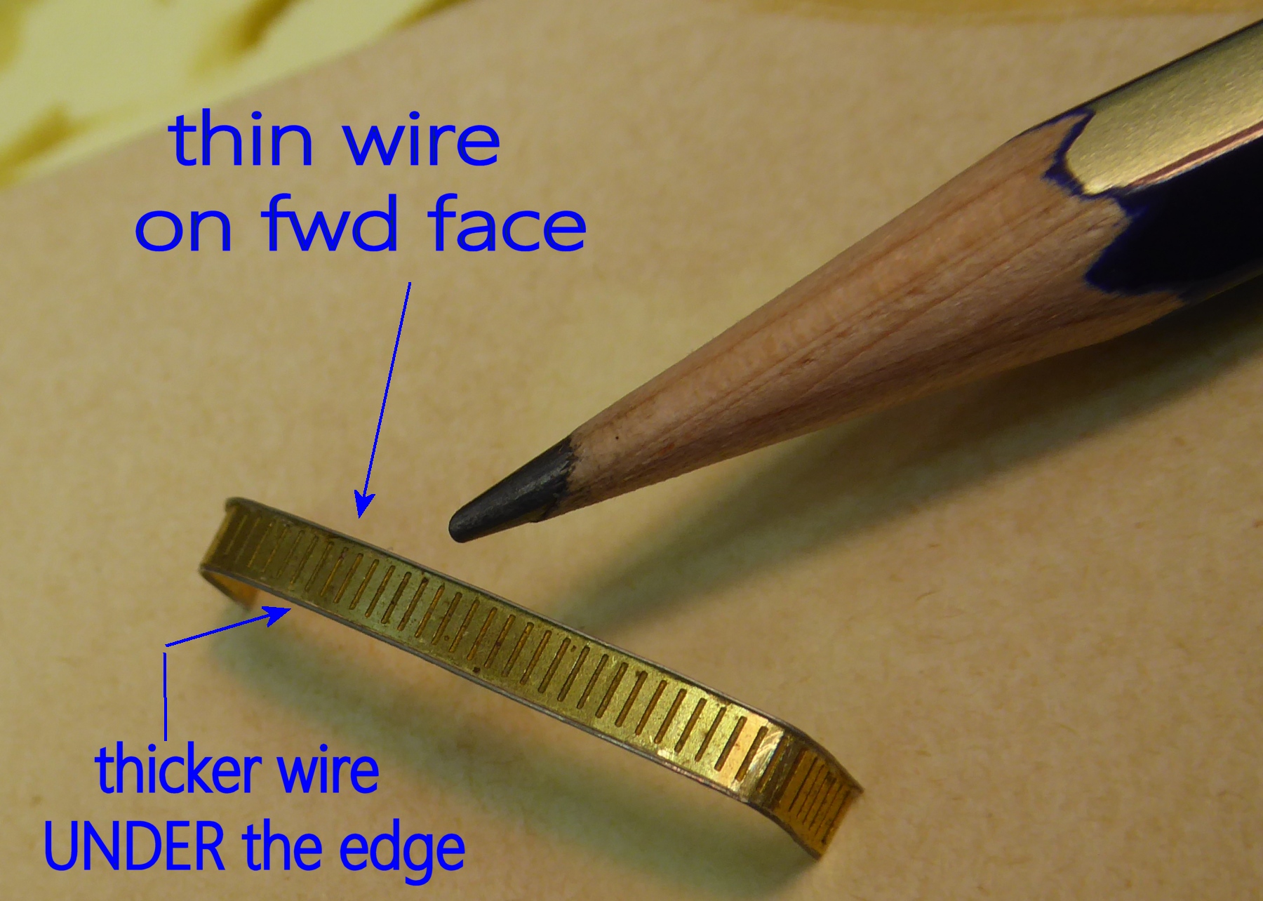

To make these-- I cut some recesses into the aluminium tubes that were to be the funnels
with an old KS metals miniature tube cutter
I then made some rings of thin wire that would sit within the grooves
( fiddly to get the size EXACTLY right..!
The result was that one had instant location of rings on funnels, with the
recessing of the rings into the funnel giving an effect of half-round section
and more subtle

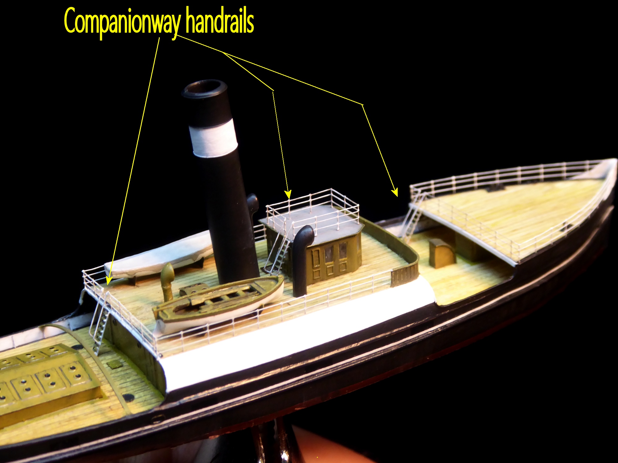

next on the works list are the mooring bollards, fairlead fwd, anchors, rails on wheel-house roof with a binnacle,
4 x Davits for the boats, make handrails of wire for the stairways, 2 x masts,lifebelts etc etc
mount it on water ( and decide how fast it will be going! !)
so it will keep me busy!

the ends were backfilled in situ with thinned white glue to
simulate it being a casting

The companionway stairs had their handrails bent up from thin wire to suit the steep inclines
