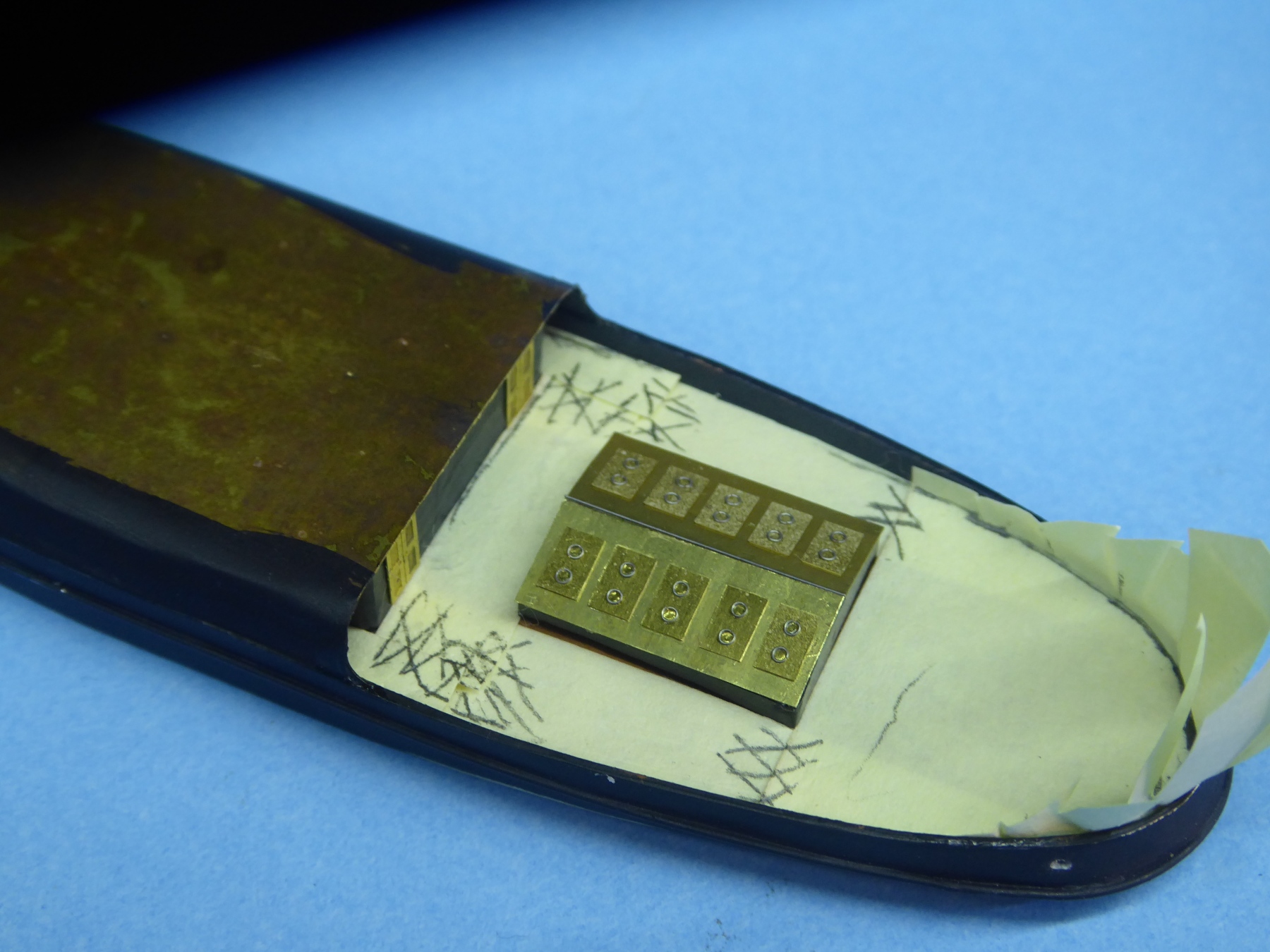

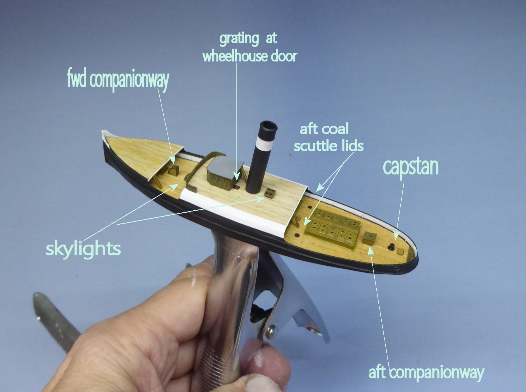

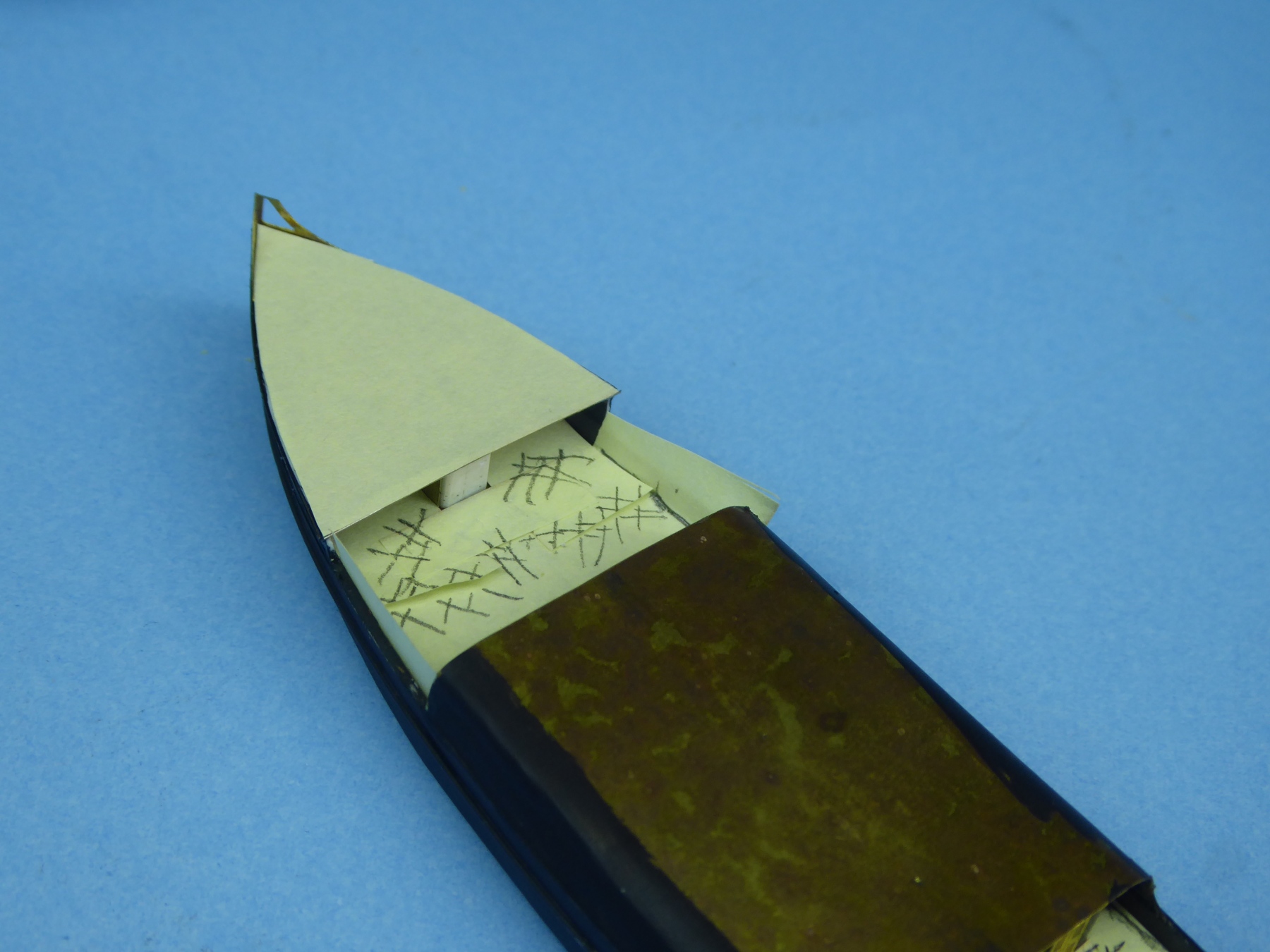

the decks back thenon Dutch Tugs were -in the main--wood covered--
so making some templates for this on a part made hull-- always good for a new challenge
using the self adhesive edges of post-it- notes spliced and strike-marked for re-assembly off the model
These templates were assembled and re-cut as a 1 piece template and corrected and recuit again
before transferring outlines to ' wood' decking sheet '
fine tuning the fit and installing to the hull ( with the brass deck removed again for access )

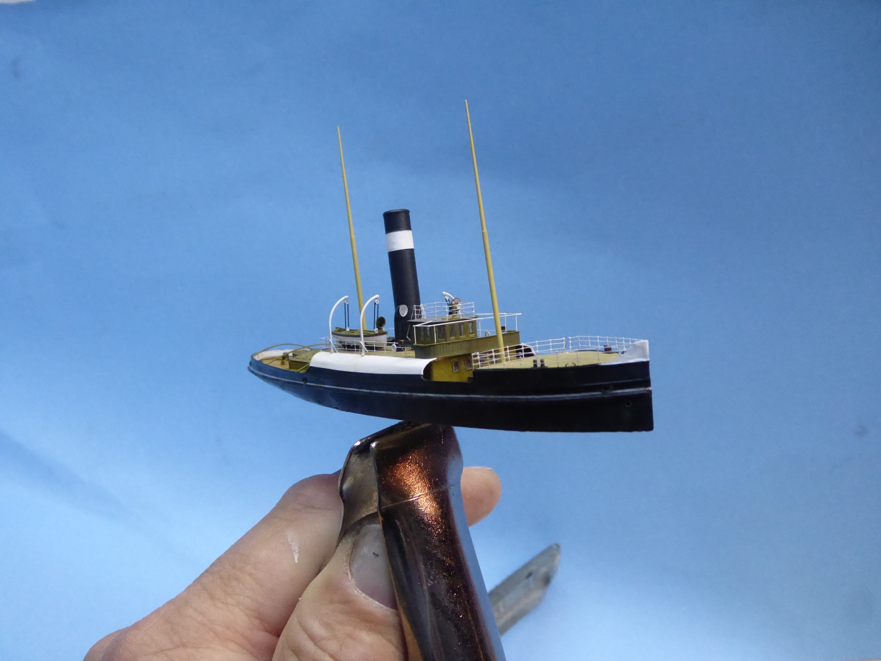

Overall views of current state
