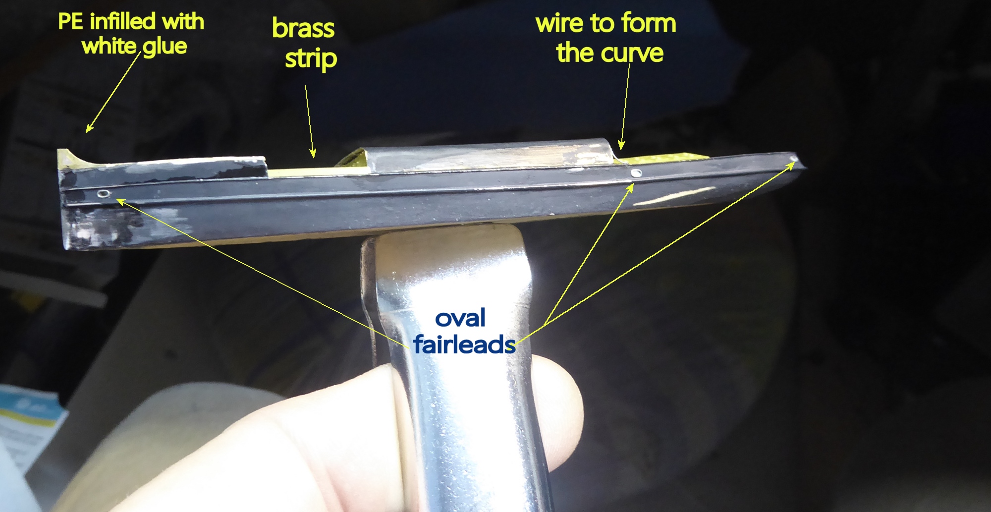

I made some rope port openings as ovals ( wire wrapped into coil around 2 drill bits )
these were installed with other pieces of wire to form the curved ends to the brass deck

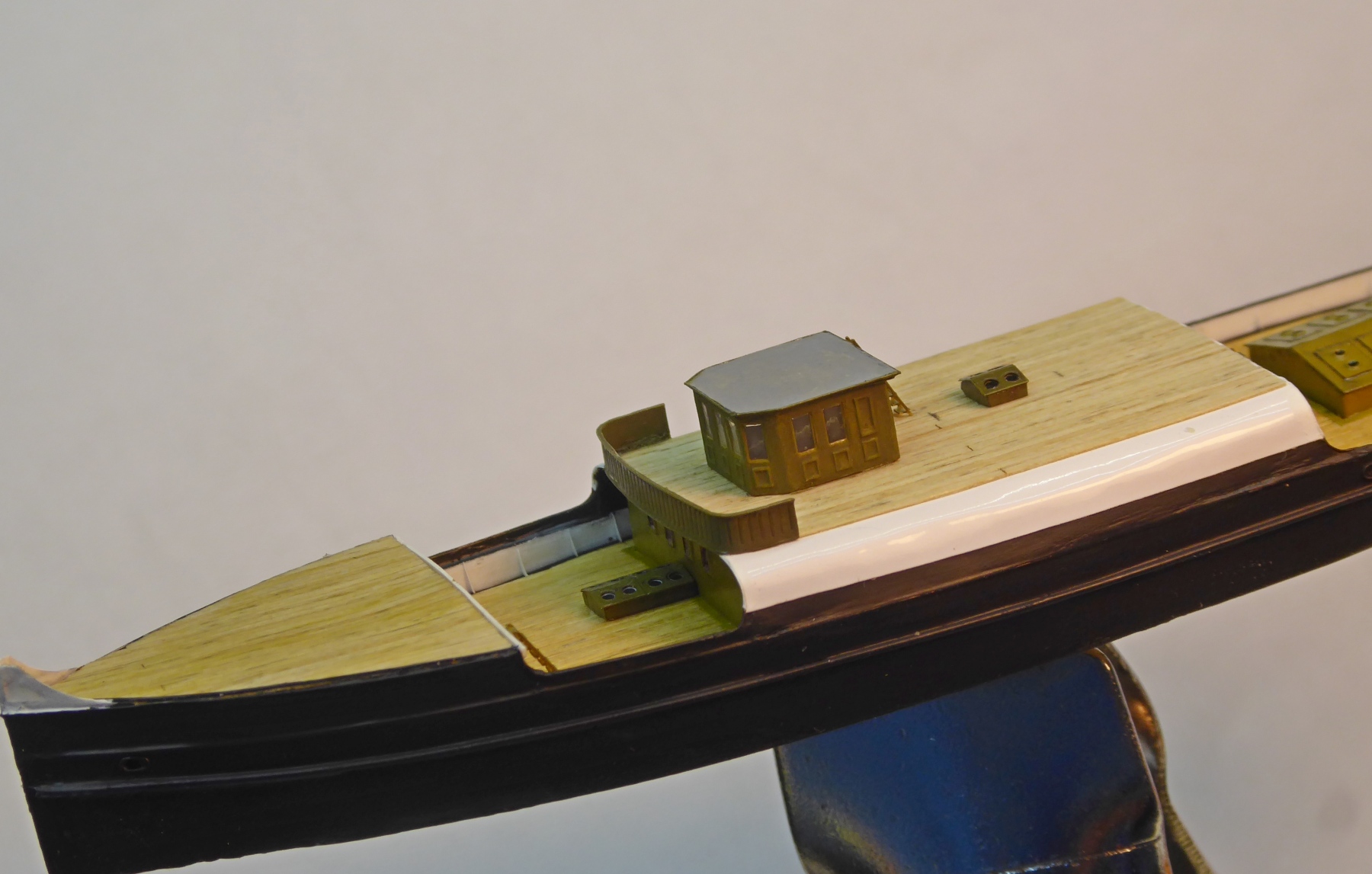

The bridge on these vessels seem to be often wooden , with a timber capping rail at the top.
I made mine using some gently curved 1/350 PE torpedo net shelving ( WEM Borodino)

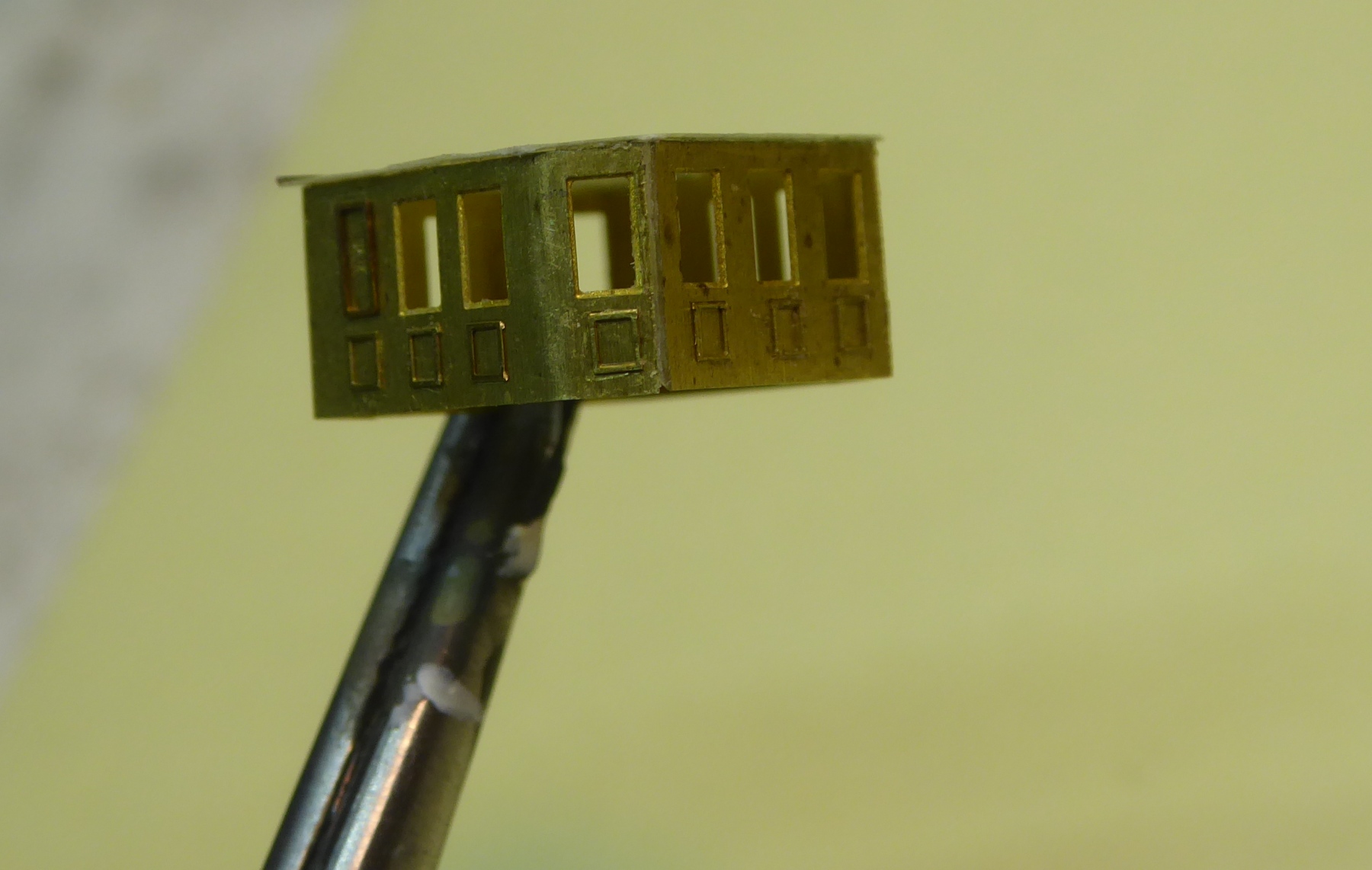

The pilot house I cut, bent around and shut from some spare PE ( fittingly! from the Vulkan kit PE )
The simulated implied wood panelling was made using squares of ladder stock and suitable cropped handrail PE
glues on with thinned varnish- the roof was cut of paper and soaked in CA

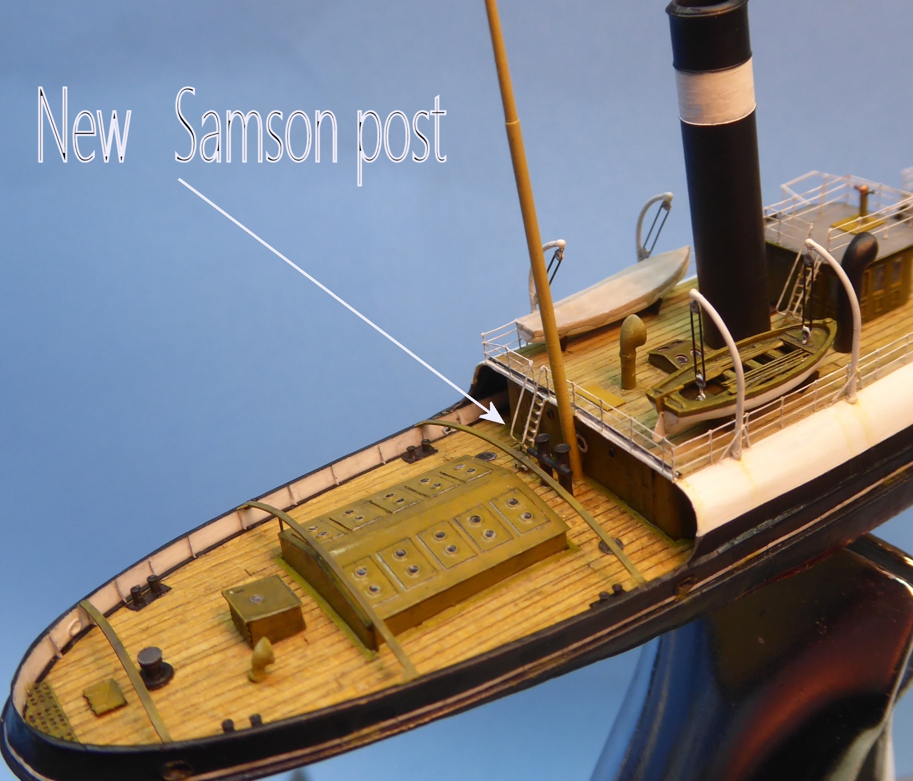

I added another cowl vent midships aft of the skylight. I had an old plastic item from an unknow donor source
which was suitable; BUT it was solid.
As ever I drilled it out, and honed it until it became acceptable
next on the works list are the mooring bollards, fairlead fwd, anchors, rails on wheel-house roof with a binnacle,
4 x Davits for the boats, make handrails of wire for the stairways, 2 x masts,lifebelts etc etc
mount it on water ( and decide how fast it will be going! !)
so it will keep me busy!

the ends were backfilled in situ with thinned white glue to
simulate it being a casting

The tug had some subtle weathering applied to the hull--
YThese vessels show the signs of hard use,
but are never tatty or neglected
-- less is more-- as based on photos.

I was told --by my Tug mentor.... :big_grin:
That my Samson towing posts was insufficiently large-- so off came the old ...
and a new one was constructed, thicker material for the uprights, and taller

Love those beautiful masts, ratlines, the better proportioned and shaped Samson post, and I'm in awe for the awning! And you didn't miss the compass binnacle on top of the wheelhouse.
Maarten
